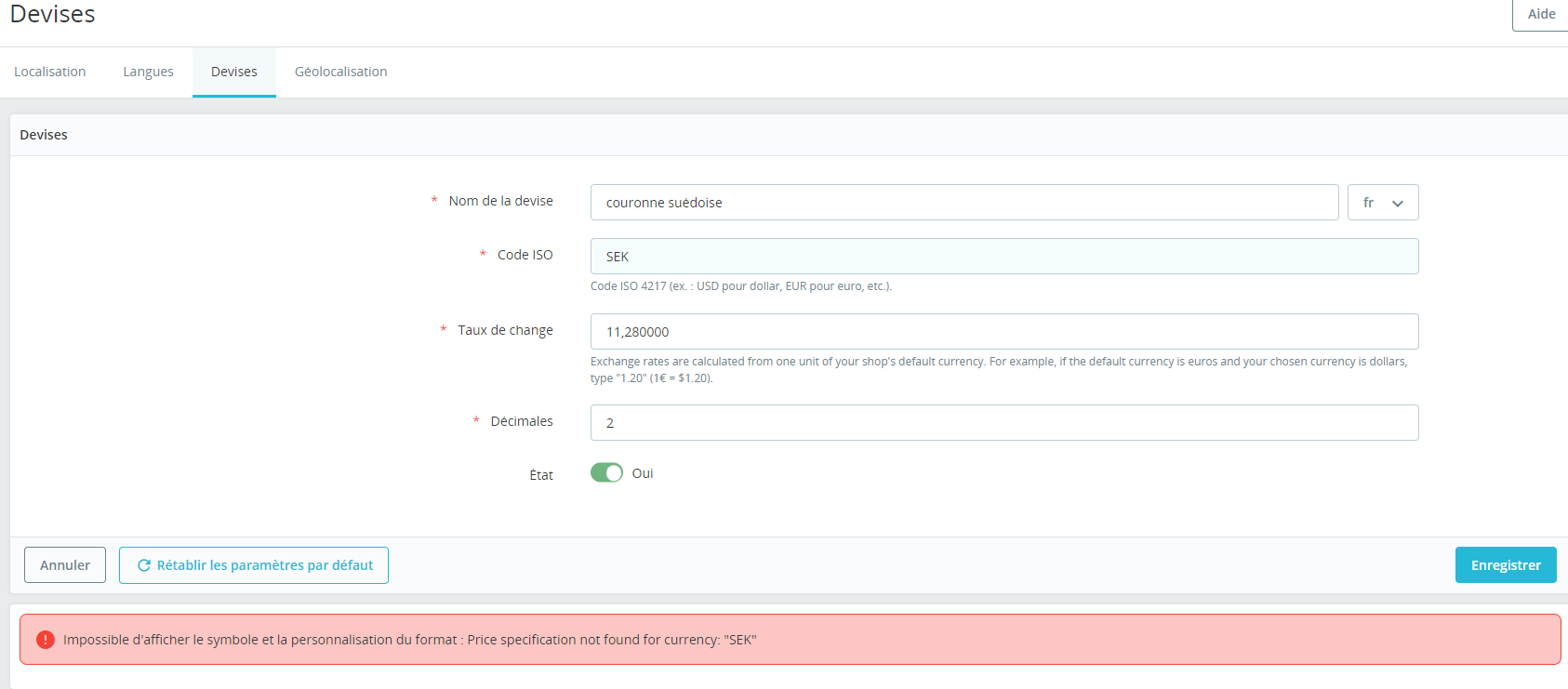

Hello, I have set 3 localisation packs associated to 3 currencies : EUR, GBP and SEK for sweden people.
The 2 first packs do not have any issues but when I import other languages, the currency seems not well set.
Accessing the SEK currency indicates : Price specification not found for currency: "SEK" as shown on screenshot.
So contrary to many other related issues, it is not linked to order table, my data is well set for id_currency field. The different tables related to currency are well set too, I have noticed nothing wrong.
My PS is 1.7.8.11 and I had upgraded with one-click upgrade module from 1.7.8.9
After tracing the error, it appears that PricesSpecificationsMap is not set for the third currency.
My questions are : Have you encountered such behavior ? and how this object PricesSpecifications is set ? The file Locale.php has a construct taking into account this parameter which is not set correctly.
I Have tried to reimport, deactivate, activate, add other pack without nu luck, I do not succeed in setting the complete object with EUR, GBP and SEK inside.
Moreover, I have noticed that the change rate is not well displayed in admin / International / Localisation / Currencies.
