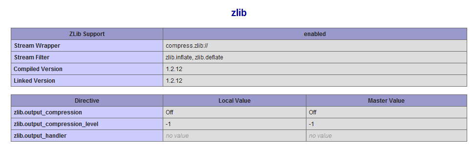

creation-handicap Posted February 19 Share Posted February 19 I tried to install Prestashop 8.1.3. on our IIS server and failed at the missing PHP ZIP extenstion. I have the ZIP activated in the php.ini and I can see it in the phpInfo (see attachment). Does somebody know, what I'm doing wrong? PS: I'm sorry, but all these advertisements on this forum is really annoying. Link to comment Share on other sites More sharing options...
Prestashop Addict Posted February 19 Share Posted February 19 This is not the right exension, this one is for http content not zip functions, you need to install:activate php extension Link to comment Share on other sites More sharing options...
creation-handicap Posted February 19 Author Share Posted February 19 Thanks! In the php.ini, I needed to tell IIS, where the extension folder is: ; Directory in which the loadable extensions (modules) reside. ; https://php.net/extension-dir ;extension_dir = "./" ; On windows: extension_dir = "ext" And then uncomment the zip extention: ;extension=soap ;extension=sockets ;extension=sodium ;extension=sqlite3 ;extension=tidy ;extension=xsl extension=zip Together with this hint, I could make it on a IIS: Link to comment Share on other sites More sharing options...
