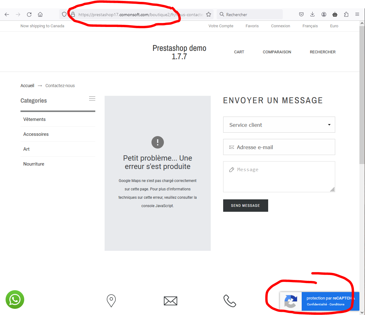

Le 10/02/2024 à 12:13 AM, EcoPets a dit :
OK.  How did you setup the captcha setting to get that to work?
When I try to put in the site with the subfolder, I get the error:
The following domain is invalid: https://www.eco-petsupplies.com/shop. A valid domain requires a host and must not include any protocol, path, port, query or fragment.
As explained just add your domain www.eco-petsupplies.com or just eco-petsupplies.com if you want to use it on sub domains also.
And as I explained, my site is in a SUBFOLDER, "eco-petsupplies.com/shop".  So it is NOT a subdomain and as such is NOT protected by the captcha.  Entering ECO-PETSUPPLIES.COM/SHOP results in the error.
What I asked was how, if possible, can recaptch protect a SUBFOLDER.
