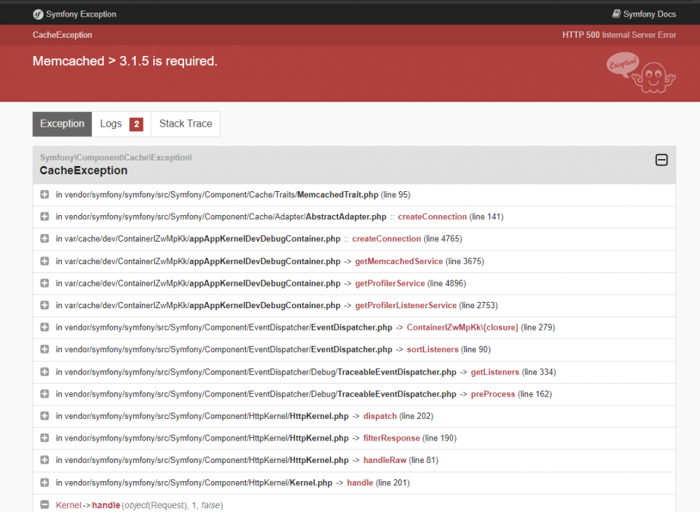

wimotek Posted February 5, 2024 Author Share Posted February 5, 2024 (edited) i turn on debug mode. here below is the screenshot. I forgot i installed php8.1. i changed back to old version of PHP7.4. everything is ok. then i closed the cache on back-office. no problem on php8.1 so the problem is memcached. how can i resoled the problem? Edited February 5, 2024 by wimotek (see edit history) Link to comment Share on other sites More sharing options...

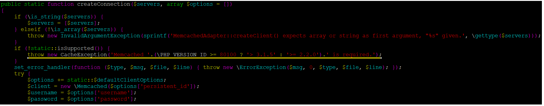

wimotek Posted February 6, 2024 Author Share Posted February 6, 2024 (edited) the problem is PHP memcached extentions. the version must > 3.1.5 the prestashop require memcached >3.1.5 when php>=8.01. i have had a try on another server . both php8.1 8.2 is OK. Edited February 6, 2024 by wimotek (see edit history) Link to comment Share on other sites More sharing options...
