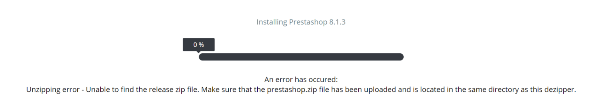

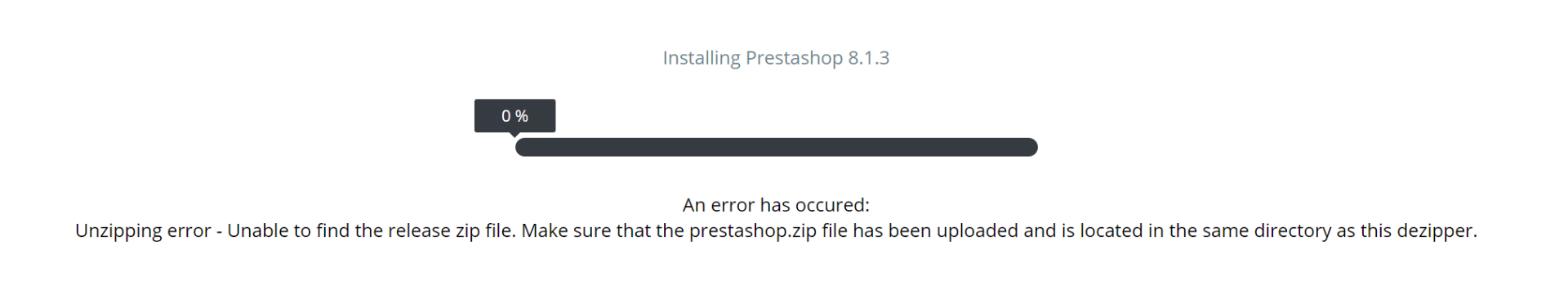

mati7716 Posted January 29, 2024 Share Posted January 29, 2024 This error occurs when updating the Prestashop version. Anyone know how to fix this? An error has occured: Unzipping error - Unable to find the release zip file. Make sure that the prestashop.zip file has been uploaded and is located in the same directory as this dezipper. Link to comment Share on other sites More sharing options...
JBW Posted January 30, 2024 Share Posted January 30, 2024 Check the chmod access right to autoupgarde directories and files on your server Link to comment Share on other sites More sharing options...

mati7716 Posted January 30, 2024 Author Share Posted January 30, 2024 Permissions are assigned correctly. It seems to me that the updater cannot locate some .zip folder to unpack and that is why there is an error. Because during a clean Presta installation, the installer unpacks the prestashop.zip file Link to comment Share on other sites More sharing options...
JBW Posted January 30, 2024 Share Posted January 30, 2024 Oh sorry, you are installing (your subject said upgrade). In this case your server should be empty expect following files (including the missing prestashop.zip) Link to comment Share on other sites More sharing options...
mati7716 Posted January 30, 2024 Author Share Posted January 30, 2024 You read that right, I'M UPDATING prestashop to version 8.x Error during UPDATE -> Make sure that the prestashop.zip file has been uploaded and is located in the same directory as this dezipper. I only suggested that there are 3 files during installation, one of which is in .zip format Link to comment Share on other sites More sharing options...
JBW Posted January 30, 2024 Share Posted January 30, 2024 Your screenshot is showing install screen, very confusing. How do your trigger the upgrade? For upgrade you should use free 1-click-upgrade module Link to comment Share on other sites More sharing options...
mati7716 Posted January 30, 2024 Author Share Posted January 30, 2024 I am updating prestashop doing everything with correct guide. I was also surprised that the installation screen and not the update screen appeared. https://devdocs.prestashop-project.org/8/basics/keeping-up-to-date/upgrade/ Link to comment Share on other sites More sharing options...
JBW Posted January 30, 2024 Share Posted January 30, 2024 Which method do you try? As stated on your linked page there are only 1-click-upgrade and CLI - I see neither on your screenshots Link to comment Share on other sites More sharing options...

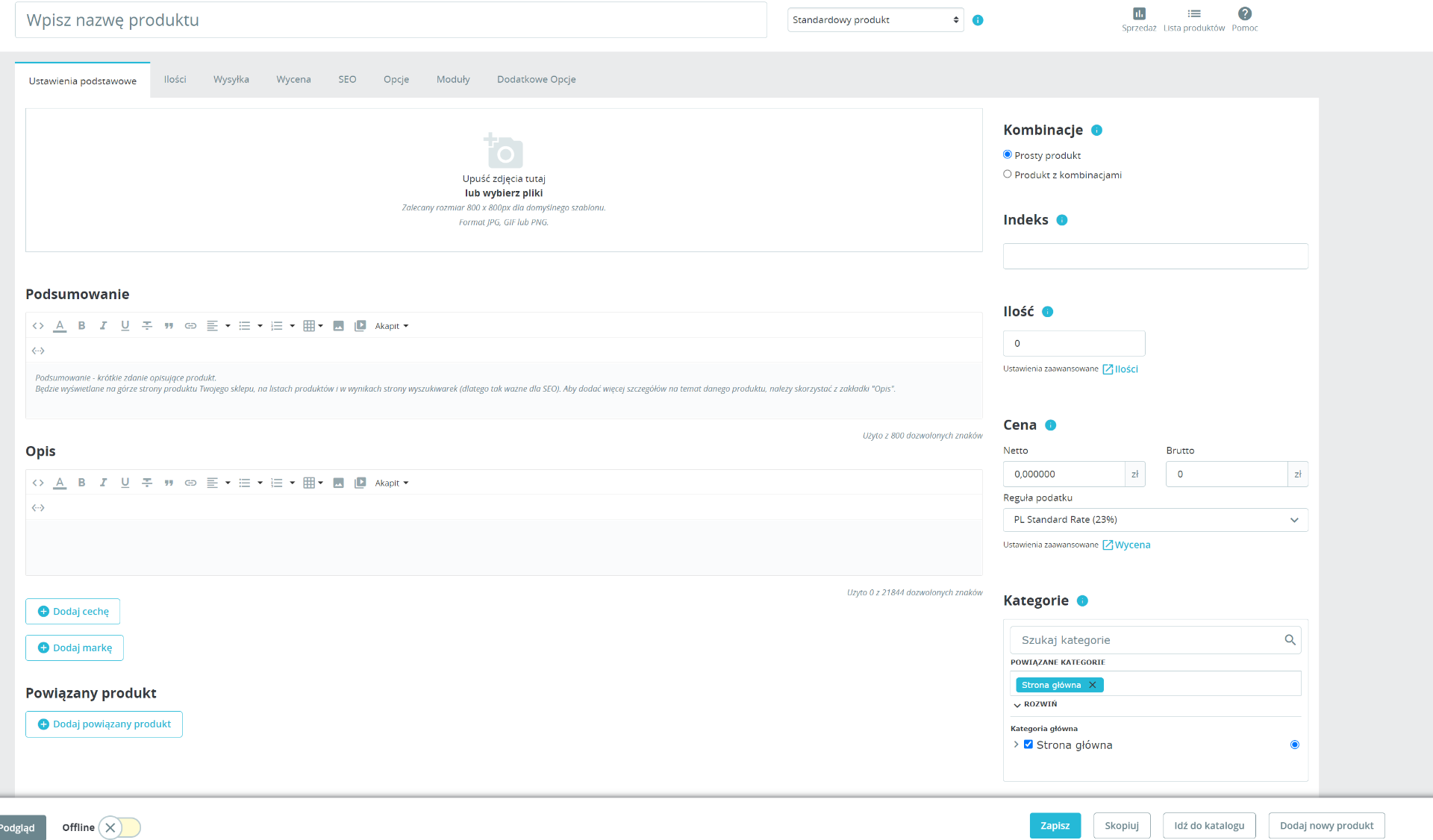

mati7716 Posted January 30, 2024 Author Share Posted January 30, 2024 Manual update is better, I updated with a module and didn't have many functions Link to comment Share on other sites More sharing options...

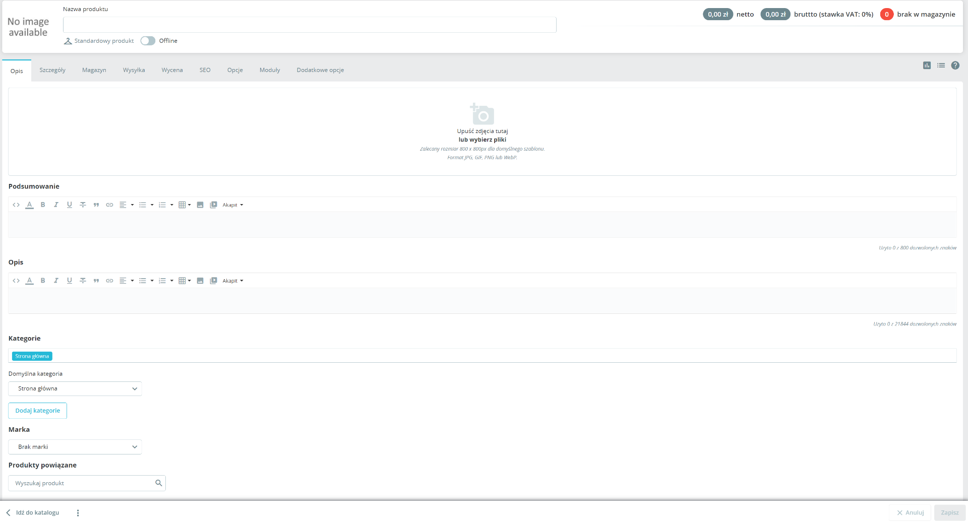

mati7716 Posted January 30, 2024 Author Share Posted January 30, 2024 I updated the store with the 1-click upgrade module. The product page for the 8.x release is confirmed by the registration certificate: product page after update Link to comment Share on other sites More sharing options...

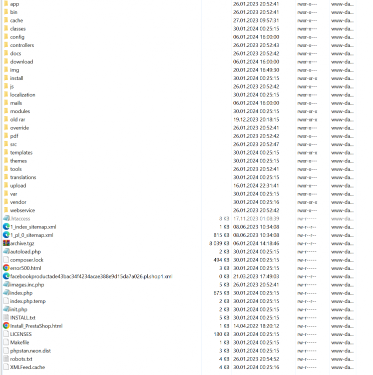

mati7716 Posted January 30, 2024 Author Share Posted January 30, 2024 when I install manually I have two problems. 1.I extract the prestashop.zip file to the main file containing Install_PrestaShop.html and index.zip. I move all this content to the folder with the old Prestashop version 2. Unzip only prestashop.zip and I move all this content to the folder with the old Prestashop version Link to comment Share on other sites More sharing options...
