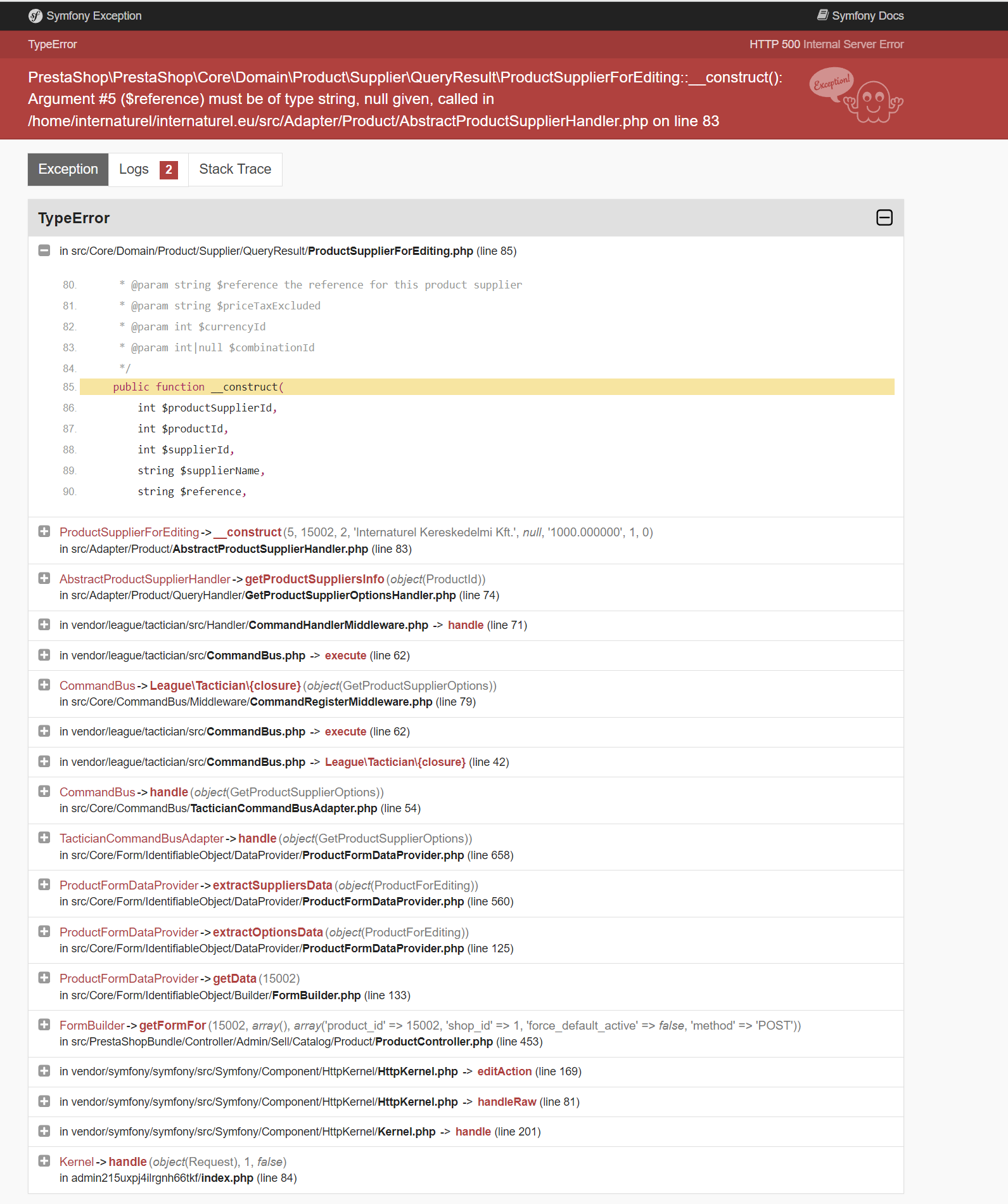

Zoltán Vasvári Posted January 24, 2024 Share Posted January 24, 2024 Hi, After migrating 7.7.1 products to brand new 8.1 store 90% of products work well, but few is not editable with following php error. These products are set with same supplier and no different in database file compared to other products that work well. Why is there this string problem? PrestaShop\PrestaShop\Core\Domain\Product\Supplier\QueryResult\ProductSupplierForEditing::__construct(): Argument #5 ($reference) must be of type string, null given, called in /home/internaturel/internaturel.eu/src/Adapter/Product/AbstractProductSupplierHandler.php on line 83 Uncaught PHP Exception TypeError: "PrestaShop\PrestaShop\Core\Domain\Product\Supplier\QueryResult\ProductSupplierForEditing::__construct(): Argument #5 ($reference) must be of type string, null given, called in /home/internaturel/internaturel.eu/src/Adapter/Product/AbstractProductSupplierHandler.php on line 83" at /home/internaturel/internaturel.eu/src/Core/Domain/Product/Supplier/QueryResult/ProductSupplierForEditing.php line 85 Link to comment Share on other sites More sharing options...

PrestaServicePro Posted January 25, 2024 Share Posted January 25, 2024 Hello, It seems like the issue is related to the product supplier reference being set as null in certain cases. This can occur when there is a mismatch or inconsistency in the database, particularly when the supplier is assigned to one table but not to another. Here are a few steps you can take to address this: 1) Check Supplier Existence: Ensure that the suppliers mentioned for these products exist in your new 8.1 store. If there's any mismatch, you might need to create or update the supplier entries. 2) Check Database Consistency: Verify the consistency of the database entries for these products. Cross check the tables related to product suppliers to make sure the information is coherent. 3) Update Supplier Information: If necessary, update the supplier information for the affected products. This can be done either through the back office or directly in the database. 4) Review Migration Process: Double check the migration process to ensure that all supplier-related information is accurately transferred from the 7.7.1 store to the new 8.1 store. After making these checks, you should be able to resolve the issue. If the problem persists or you need further assistance, feel free to provide more details, and we'll be happy to help. Good day 1 Link to comment Share on other sites More sharing options...

PrestaServicePro Posted January 27, 2024 Share Posted January 27, 2024 We’re delighted to hear that the issue has been resolved by deleting the NULL value in the ps_product_supplier dimension. It's great that you were able to identify and implement the solution. If you could update the post title to "solved," it would be immensely helpful for others facing a similar challenge. This way, they can quickly find the solution and apply it to their situations. Happy sales! 1 Link to comment Share on other sites More sharing options...
