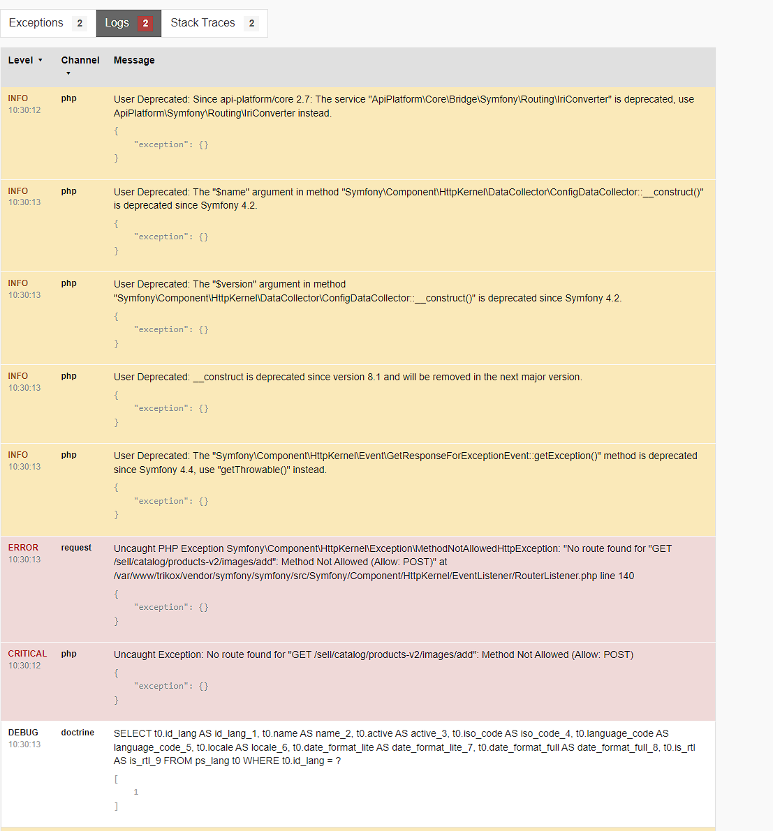

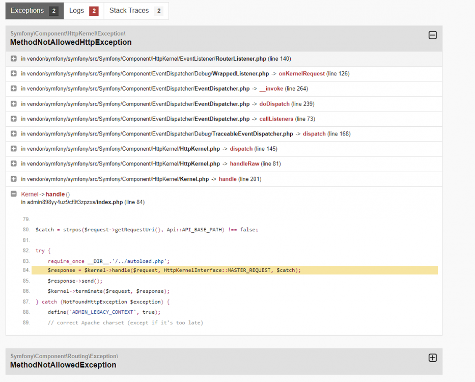

matyasvane Posted January 18 Share Posted January 18 (edited) Hello, I'm having trouble adding images to products with prestashop 8.1.3. I tried eMagicOne and it works fine there. I get the error: Invalid form data. Console error: Failed to load resource: the server responded with a status of 400 () Debug: No route found for "GET /sell/catalog/products-v2/images/add": Method Not Allowed (Allow: POST) How i can please fix that? Edited January 18 by matyasvane (see edit history) Link to comment Share on other sites More sharing options...

matyasvane Posted January 18 Author Share Posted January 18 the strange thing is that I can upload some pictures and some can't. They are 1.4mb in size. php is allowed 128mb. I don't know what the problem is Link to comment Share on other sites More sharing options...
matyasvane Posted January 18 Author Share Posted January 18 (edited) + i using nginx, so i dont have there mod_security. I would also like to say that it worked for me, but it stopped working after installing the SOAP php extension Ok SOAP is problem, why? Edited January 18 by matyasvane (see edit history) Link to comment Share on other sites More sharing options...
