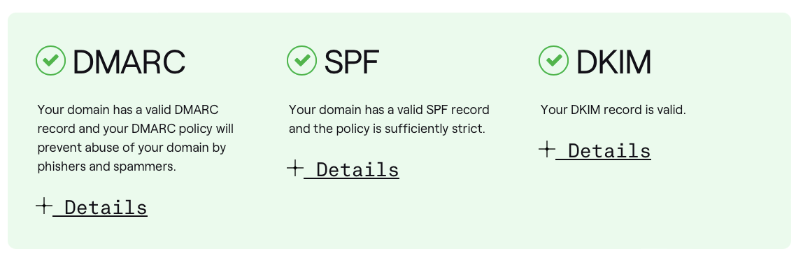

Ray UK Posted January 7, 2024 Author Share Posted January 7, 2024 3 hours ago, musicmaster said: Can you try this service to look what your Prestashop sends? https://dkimvalidator.com/ OK so that site has helped me work it out. At first the validator said the only thing failing was the DKIM. In Prestashop 8 there is now the option to add the DKIM settings, so I entered them there.. but at this point it says it should look like a domain That part is wrong it should just be the DKIM selector name because Prestashop adds ._domainkey.yourdomain.com at the end. So I have now just created the selector named "prestashop" and used https://easydmarc.com/tools/dkim-record-generator to create the DKIM signature and RSA key to enter into Prestashop. and Voila it is now passing and the emails are now being received by gmail acocunt. So thanks for your help @musicmaster 1 Link to comment Share on other sites More sharing options...
