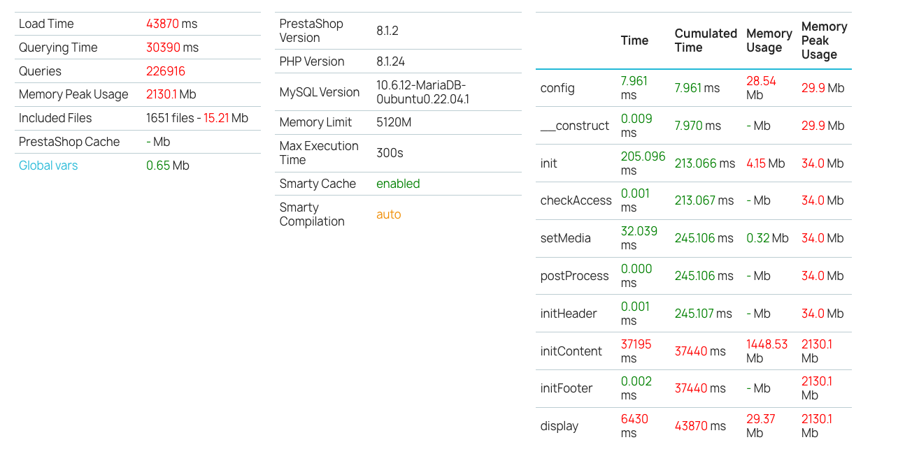

j'ai donc activé le mode profiling sur PS, et ci-dessous vous pouvez constater les résultat j'ai un INICONTENT HYPER ELEVE des requêtes énorme aussi.
  • Load Time43870 ms
  • Querying Time30390 ms
  • Queries226916
  • Memory Peak Usage2130.1 Mb
  • Included Files1651 files - 15.21 Mb
  • PrestaShop Cache- Mb
  • Global vars0.65 Mb
  • TimeCumulated     TimeMemory     UsageMemory     Peak Usage
  • config7.961 ms          7.961 ms              28.54 Mb          29.9 Mb
  • __construct0.009 ms 7.970 ms           - Mb                   29.9 Mb
  • init205.096 ms      213.066 ms            4.15 Mb             34.0 Mb
  • checkAccess0.001 ms213.067 ms- Mb34.0 Mb
  • setMedia32.039 ms245.106 ms0.32 Mb34.0 Mb
  • postProcess0.000 ms245.106 ms- Mb34.0 Mb
  • initHeader0.001 ms245.107 ms- Mb34.0 Mb
  • initContent37195 ms37440 ms1448.53 Mb2130.1 Mb
  • initFooter0.002 ms37440 ms- Mb2130.1 Mb
  • display6430 ms43870 ms29.37 Mb2130.1 Mb

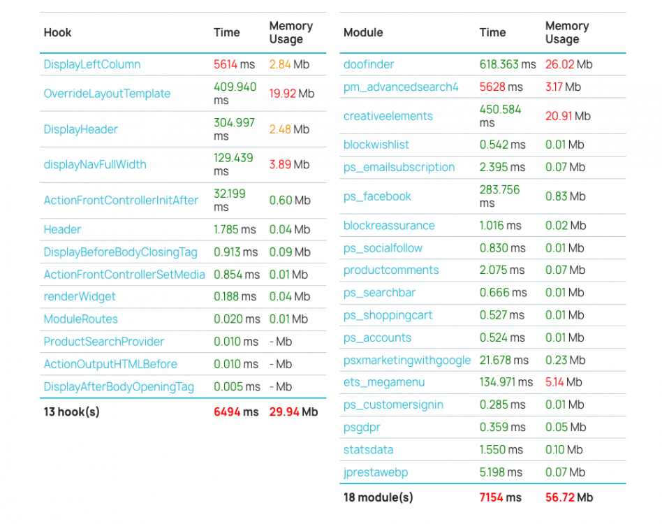

En screen le résultat du profiling

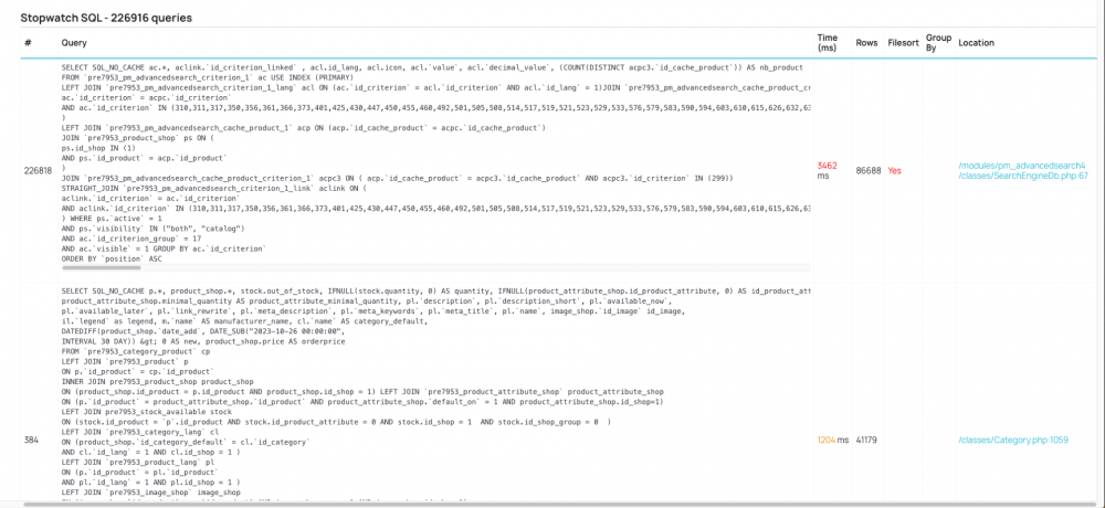

il y a 226269 REQUETE, 19 SECONDES, je suppose que le problème vient de la :
SELECT SQL_NO_CACHE COUNT(cp.`id_product`) AS total FROM `pre7953_product` p INNER JOIN pre7953_product_shop product_shop ON (product_shop.id_product = p.id_product AND product_shop.id_shop = 1) LEFT JOIN `pre7953_category_product` cp ON p.`id_product` = cp.`id_product` WHERE cp.`id_category` = 18 AND product_shop.`visibility` IN ("both", "catalog") AND product_shop.`active` = 1 LIMIT 1
/classes/Category.php:988
/src/Adapter/Category/CategoryProductSearchProvider.php:88 (getProducts)
/src/Adapter/Category/CategoryProductSearchProvider.php:106 (getProductsOrCount)
/classes/controller/ProductListingFrontController.php:357 (runQuery)
/classes/controller/ProductListingFrontController.php:635 (getProductSearchVariables)
/controllers/front/listing/CategoryController.php:138 (doProductSearch)
/tools/profiling/Controller.php:60 (initContent)
/classes/Dispatcher.php:510 (run)
/index.php:28 (dispatch)
