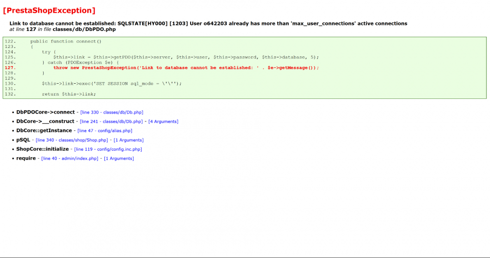

Julie Del Posted October 26, 2023 Author Share Posted October 26, 2023 On 10/23/2023 at 3:42 PM, Mediacom87 said: Bonjour, 1- videz manuellement le cache 2- si aucune correction, alors activez le mode debug et transmettez-nous l'erreur. Voici ce que j'ai eu après activer le mode debug. Link to comment Share on other sites More sharing options...
