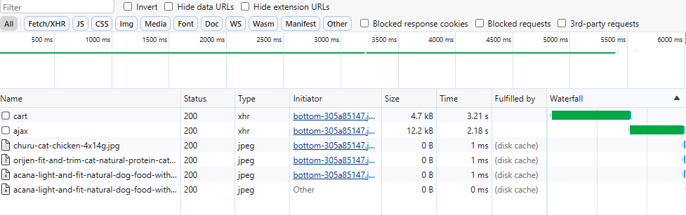

Santietsit Posted September 22, 2023 Share Posted September 22, 2023 Hi, I am almost finalized with the overall design of the website (https://patitasco.com/en/). I have a decent amount of product items (each with several combinations) but nothing crazy, and run a basic IONOS server. My surprise is that despite the website is not slow (could be faster thought), the time it takes to add products to the cart is too much (more than 4 seconds) which in my view is a no-go for the customer. Is there any particular area in the code that is creating the issue, or it is a matter of having a slow server and I should upgrade to a dedicated one? Link to comment Share on other sites More sharing options...

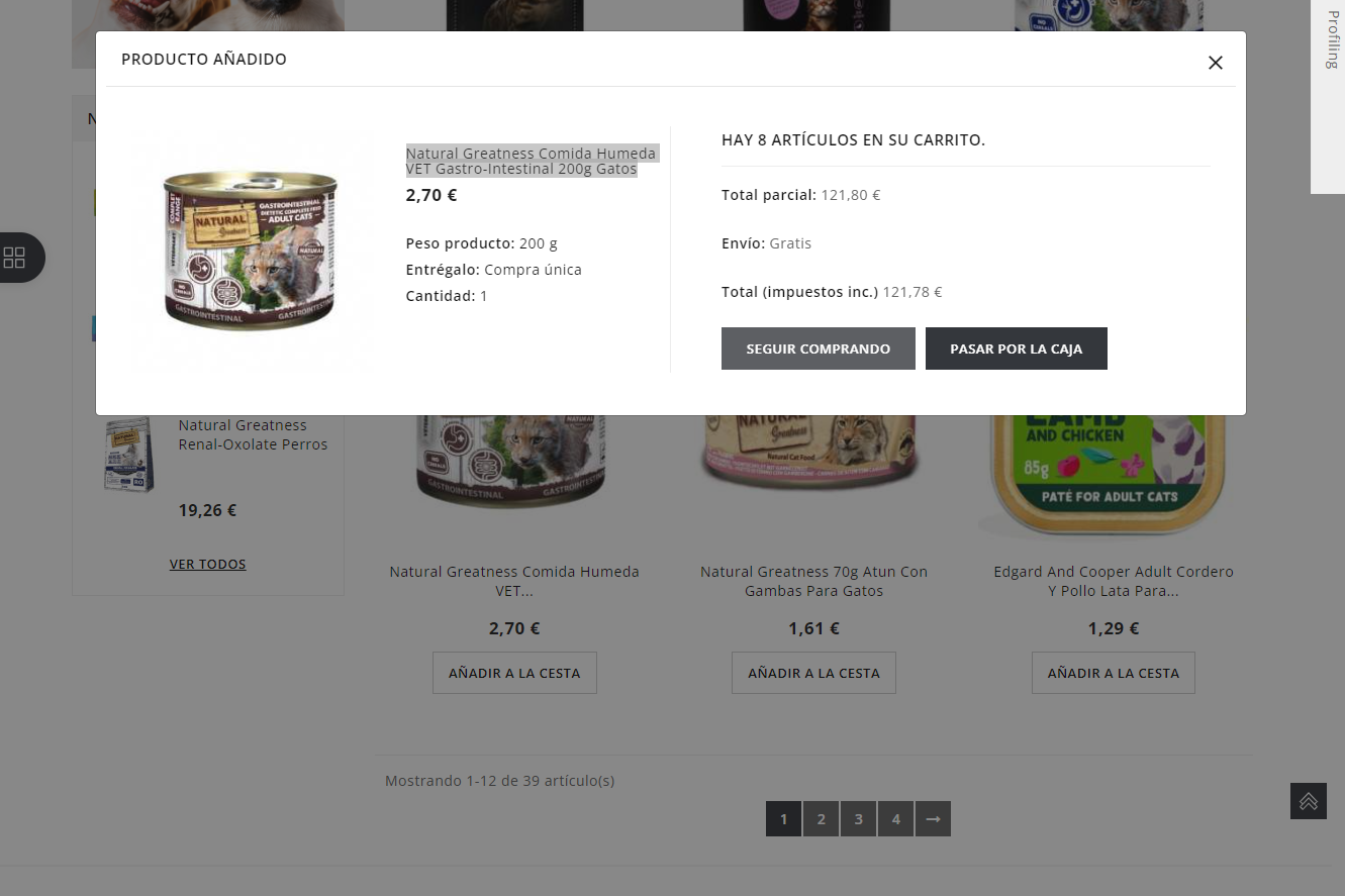

Santietsit Posted September 24, 2023 Author Share Posted September 24, 2023 This is super useful and gave me the ability to also remove some modules that I was not using. The problem is that when clicking the buttong of "add to cart", as it is just a pop-up, I do not think it shows the statistics, do you know a way to be able to have those stats Link to comment Share on other sites More sharing options...
