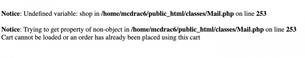

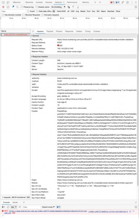

BeatsMe Posted September 12, 2023 Author Share Posted September 12, 2023 I have noticed that with the browser Developer Mode on it shows an error 500. See attached image. If you reload the page throws a "Cart cannot be loaded or an order has already been placed using this cart" error. Also see attached image. When you reload the root website and go to "My Orders", the order is there but no status. The Prestashop debug mode shows nothing. Is there anyone that can help with any idea of what the problem might be?? Link to comment Share on other sites More sharing options...
BeatsMe Posted September 14, 2023 Author Share Posted September 14, 2023 Hey, Just wondering if anyone might know what this error means... [14-Sep-2023 12:48:17 Australia/Sydney] PHP Notice:Â Undefined variable: shop in /home/mcdrac6/public_html/classes/Mail.php on line 253 [14-Sep-2023 12:48:17 Australia/Sydney] PHP Notice:Â Trying to get property of non-object in /home/mcdrac6/public_html/classes/Mail.php on line 253 Two error lines when a customer placed an order today. Hoping for a solution. Thanks for looking. Link to comment Share on other sites More sharing options...
