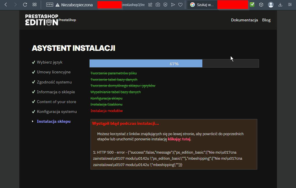

I've got the same problem , when trying to install PS 1.8.1.1 on my testing Centos 7.9 (with Apache/2.4.6 (CentOS) PHP/7.4.33 and MySQL version: 5.5.68-MariaDB) . And just like severall of my predecessors said the error messages started with module-installing sections and it looks just like :
[Wed Nov 01 01:53:21.506077 2023] [php7:notice] [pid 16046] [client 192.168.xx.xx:37144] PHP Notice:  Constant _PS_DO_NOT_LOAD_CONFIGURATION_ already defined in /var/www/html/prestashop3/install/controllers/http/smarty_compile.php on line 26, referer: http://192.168.vv.vv/prestashop3/install/index.php
[Wed Nov 01 01:53:22.574129 2023] [php7:notice] [pid 16047] [client 192.168.xx.xx:37145] PHP Notice:  Constant _PS_DO_NOT_LOAD_CONFIGURATION_ already defined in /var/www/html/prestashop3/install/controllers/http/smarty_compile.php on line 26, referer: http://192.168.vv.vv/prestashop3/install/index.php
[Wed Nov 01 01:53:22.820724 2023] [php7:notice] [pid 16054] [client 192.168.xx.xx:37146] PHP Notice:  Trying to get property 'theme_name' of non-object in /var/www/html/prestashop3/var/cache/prod/ContainerTsfCJnz/appAppKernelProdContainer.php on line 3416, referer: http://192.168.vv.vv/prestashop3/install/index.php
[Wed Nov 01 01:53:27.796655 2023] [php7:notice] [pid 16054] [client 192.168.xx.xx:37146] PHP Notice:  Trying to get property 'theme_name' of non-object in /var/www/html/prestashop3/var/cache/prod/ContainerCj5fiol/appAppKernelProdContainer.php on line 2868, referer: http://192.168.vv.vv/prestashop3/install/index.php
[Wed Nov 01 01:59:29.457321 2023] [php7:notice] [pid 16047] [client 192.168.xx.xx:37202] PHP Notice:  Constant _PS_DO_NOT_LOAD_CONFIGURATION_ already defined in /var/www/html/prestashop3/install/controllers/http/smarty_compile.php on line 26, referer: http://192.168.vv.vv/550725 2023] [php7:notice] [pid 16054] [client 192.168.xx.xx:37203] PHP Notice:  Constant _PS_DO_NOT_LOAD_CONFIGURATION_ already defined in /var/www/html/prestashop3/install/controllers/http/smarty_compile.php on line 26, referer: http://192.168.vv.vv/prestashop3/install/index.php?restart=true
[Wed Nov 01 01:59:31.206709 2023] [php7:notice] [pid 16045] [client 192.168.xx.xx:37204] PHP Notice:  Trying to get property 'theme_name' of non-object in /var/www/html/prestashop3/var/cache/prod/Container8F1Qxxl/appAppKernelProdContainer.php on line 2906, referer: http://192.168.vv.vv/prestashop3/install/index.php?restart=true
[Wed Nov 01 01:59:36.933756 2023] [php7:notice] [pid 16045] [client 192.168.xx.xx:37204] PHP Notice:  Trying to get property 'theme_name' of non-object in /var/www/html/prestashop3/var/cache/prod/ContainerRHATLcZ/appAppKernelProdContainer.php on line 3416, referer: http://192.168.vv.vv/prestashop3/install/index.php?restart=true
(of course I've changed the last octets of IP addresses )

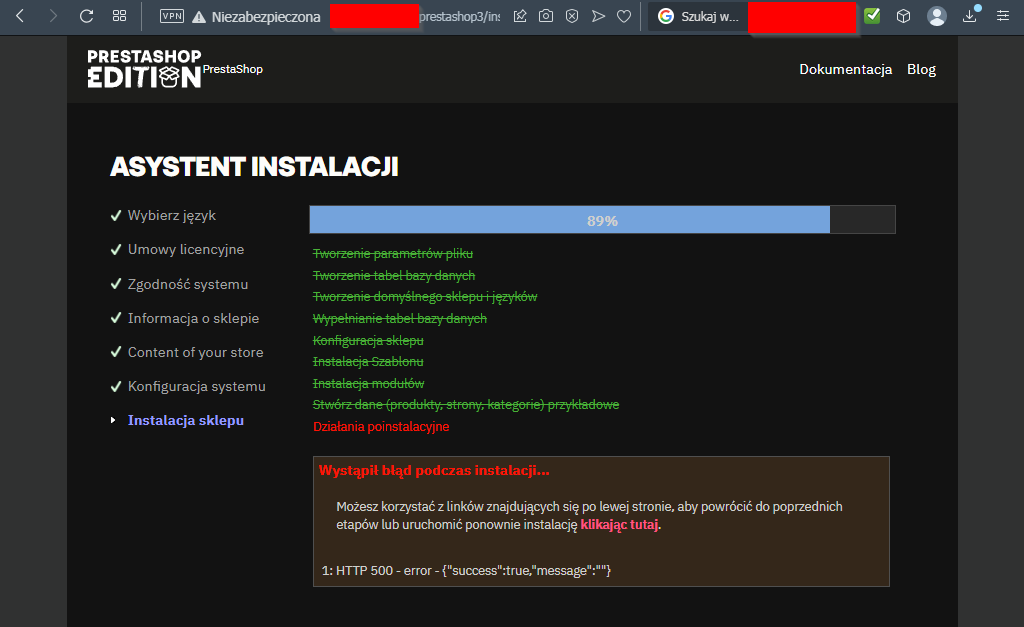

From the browser point of view - this looks like :
2023-11-0102_26_10-AsystentinstalacjiPrestaShopOpera.thumb.png.5fe26b4e96d76ea96bcc0c45614dd25a.png
2023-11-0102_18_46-AsystentinstalacjiPrestaShopOpera.thumb.png.3baf1448e417eb26c4812e57aad44420.png
Do You PS Guys & Developers - know - WHAT is the real REASON OF THIS DISTURBING PROBLEM ??
And HOW TO better TROUBLESHOOT IT ???
(No, that's obviously not the problem of configuration php - I've tested severall configurations esp. with very enlarged time_liimits ... and so on - and nothing makes the difference at all !)
Additionally - the problem DOES NOT affect the PS 1.7.xx versions - but only 1.8 releases !!
Regards
Edited by markooff (see edit history)
