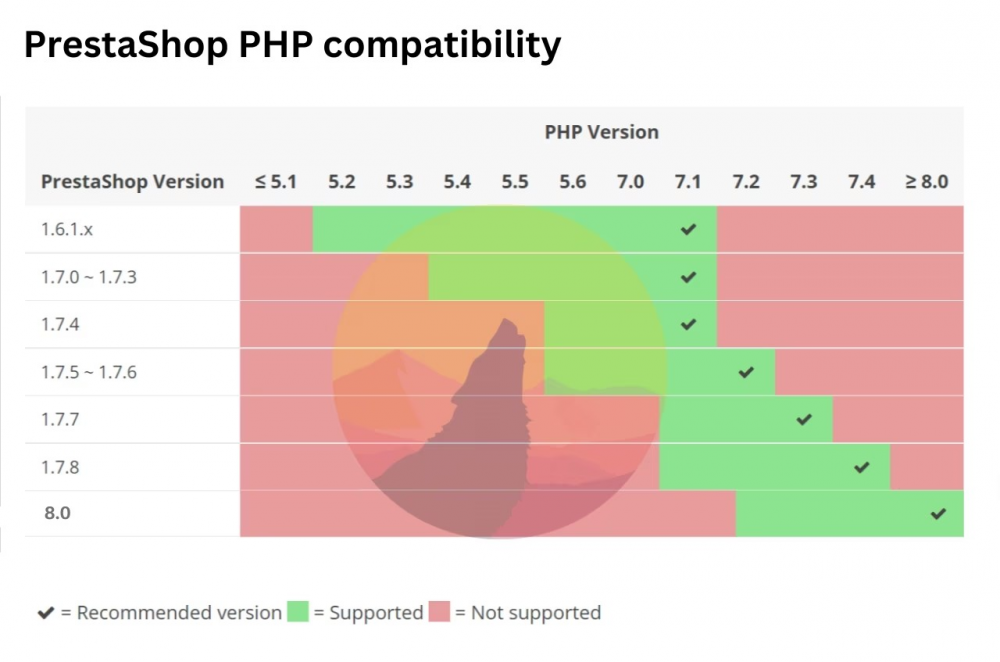

4presta Posted April 6, 2023 Share Posted April 6, 2023 I agree with @Nickz There is no basic information about Prestashop version and PHP version. Some hostings remove old PHP versions (5.4, 5.6) without warning and replace with the lowest possible (7.2, 7.4 ....). Then older versions of Prestashop do not work. Link to comment Share on other sites More sharing options...
kauaianken Posted April 6, 2023 Author Share Posted April 6, 2023 (edited) I'm running Prestashop 1.6.1.24 and PHP 7.4, if that helps. Neither seems to be a deal-breaker, right? Edited April 6, 2023 by kauaianken (see edit history) Link to comment Share on other sites More sharing options...
4presta Posted April 6, 2023 Share Posted April 6, 2023 Link to comment Share on other sites More sharing options...
kauaianken Posted April 6, 2023 Author Share Posted April 6, 2023 (edited) OK, so my web host set the default PHP at 7.4. If I want to keep Prestashop 1.6, I need PHP 7.1? I’m wondering if there’s a way to install PHP 7.1 on my site…independent of the web host settings? Edited April 8, 2023 by kauaianken (see edit history) Link to comment Share on other sites More sharing options...
pcdokteruden Posted April 9, 2023 Share Posted April 9, 2023 Hello, It is definitly a php issue. Log in at your hosting provider. In most cases you can choose your desired php version in the control panel. If not, ask your provider to downgrade to your previous php version. Regards, Johan Link to comment Share on other sites More sharing options...
