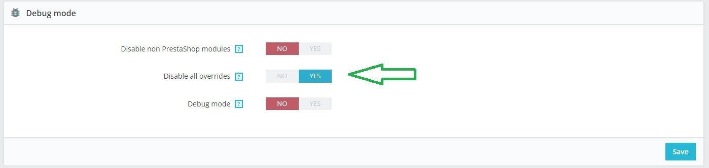

Gokay Posted January 19, 2023 Author Share Posted January 19, 2023 (edited) Advanced Parameters > Performance > Disable all overrides ->ON This is how it worked thank you for your helpbest regards Edited January 19, 2023 by Gokay (see edit history) Link to comment Share on other sites More sharing options...
PrestaHeroes.com Posted January 19, 2023 Share Posted January 19, 2023 39 minutes ago, Gokay said: Advanced Parameters > Performance > Disable all overrides ->ON This is how it worked thank you for your helpbest regards Disabling overrides will prevent modules that use overrides not to work. However this does isolate where your issue resides. Look in overrides to find your issue. Link to comment Share on other sites More sharing options...
