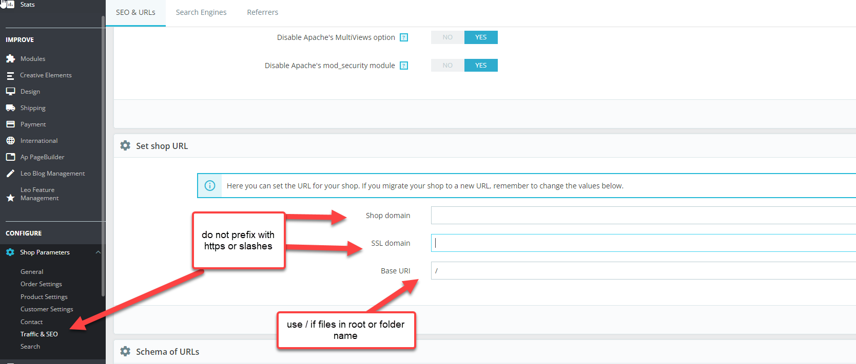

PrestaHeroes.com Posted May 18, 2022 Share Posted May 18, 2022 It would appear that your dns is not setup correctly either in host or from you domain registrar. for faster service contact your hosting company, they can generally help with this type of issue. on your hosting, you created the jparts.jp webspace and copied files there yes, but do contact your hosting because without hands on we can only guess what is issue. you can update ps_shop_url via admin, if you cannot access admin then via phpmyadmin, I think configure table. you man need to search... to update admin Link to comment Share on other sites More sharing options...

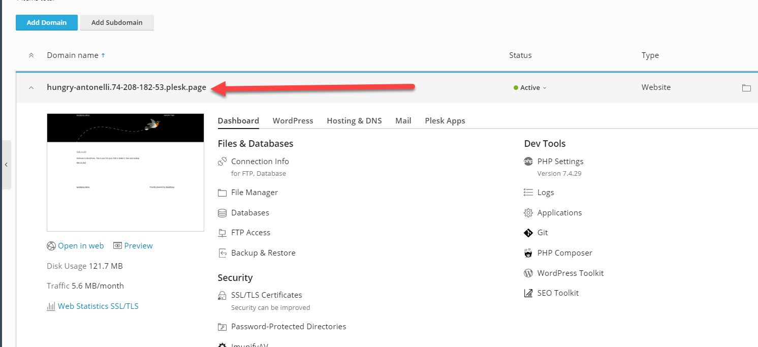

PrestaHeroes.com Posted May 19, 2022 Share Posted May 19, 2022 when you created your hosting you opted in to to use an internally generated domain name. did you create your production domain and then copy files from temporary generated domain name? (it would connect to existing mysql). here is example, where I am using a temp internal domain that I can test with, to move to production I would create prod domain and copy files over. then switch dns hope this helps Link to comment Share on other sites More sharing options...
