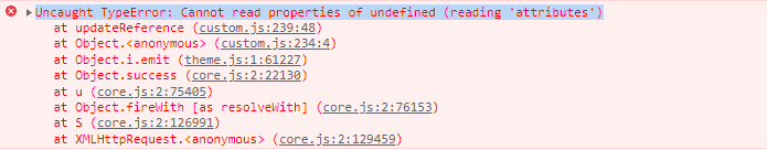

Unfortunately the code below, which is placed in custom.js does not work on prestashop 1.7.8, we have the error :
Uncaught TypeError: Cannot read properties of undefined (reading 'attributes')

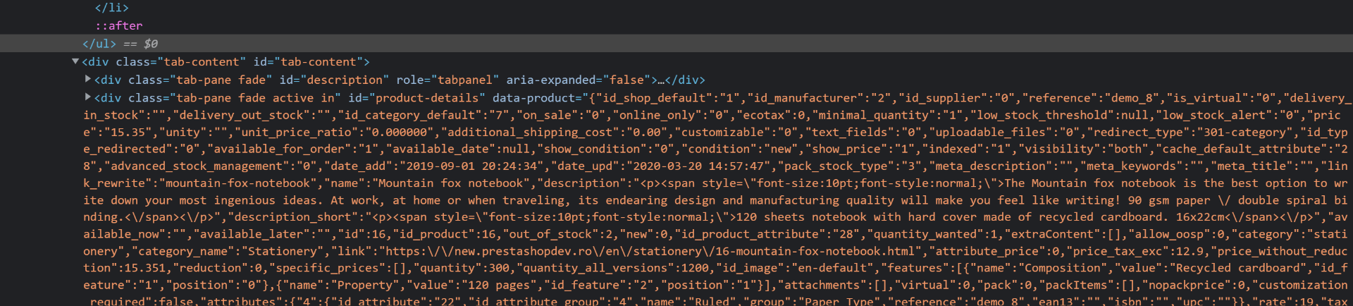

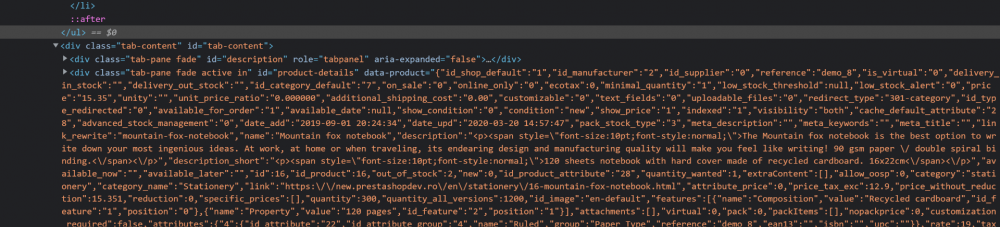

If you look in html, at the #product-details tag, you have the data-product attribute, where is a json with all the data about the product. You access those values with $('# product-details').data("product"). In json, the "attributes" value contains the data about the combination, which you access $('# product-details').data("product").attributes
I think that you don't have that attribute(data-product) that contains the product details in your #product-details tag, and that's why you get that error, that it can't read the property. Can you post the site link, can I check exactly?

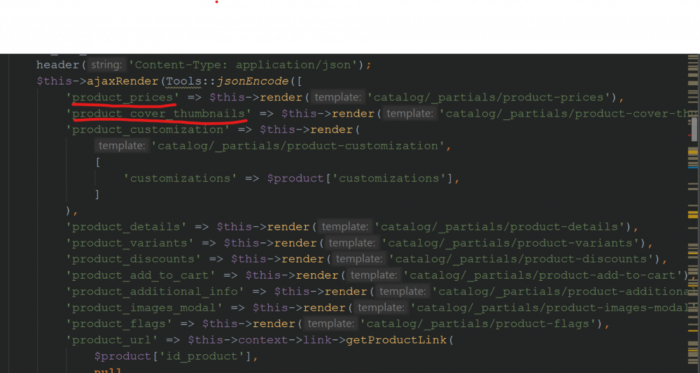

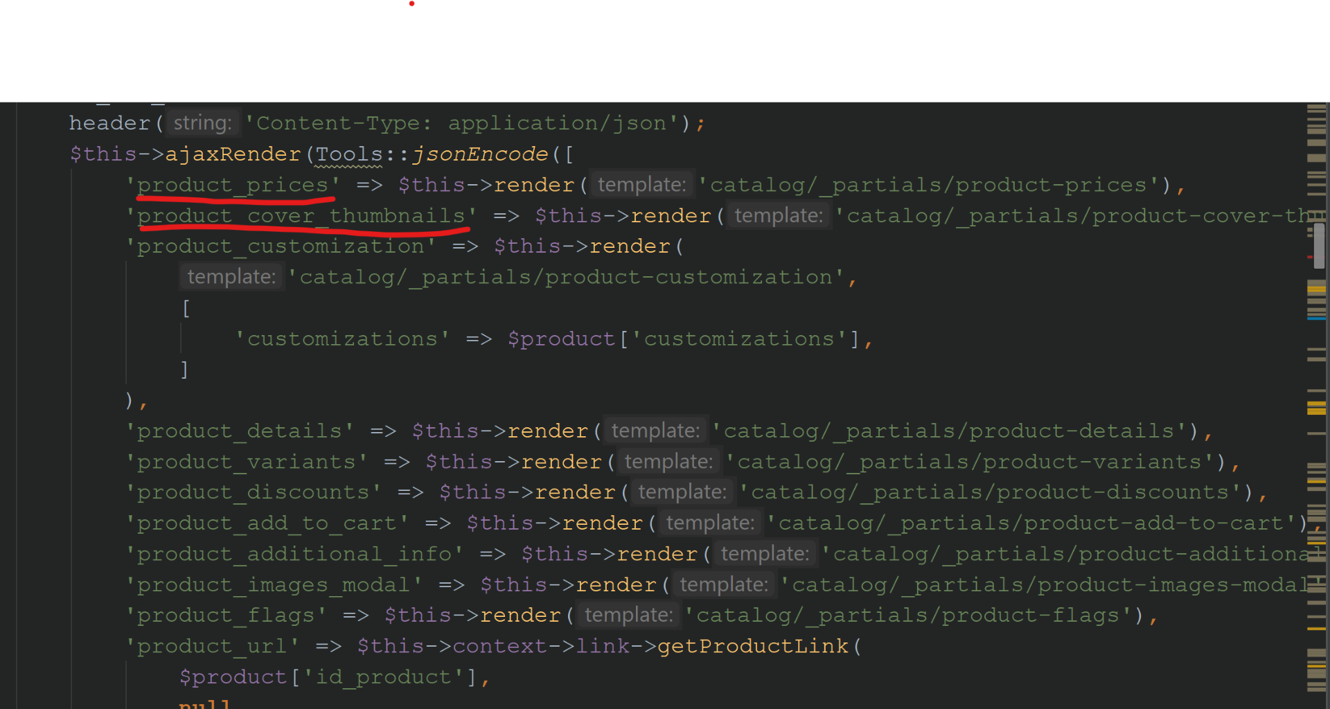

In tpl, those values are set with {$product.embedded_attributes|json_encode} variable. You can put this json somewhere in html, on another tag, and take your value from it.
By changing the combination, it refreshes certain sections of the page. In the second picture, you can see the classes of the refreshing sections, so you should put that json in one of those sections, so that when the combination is changed, it will also be updated.

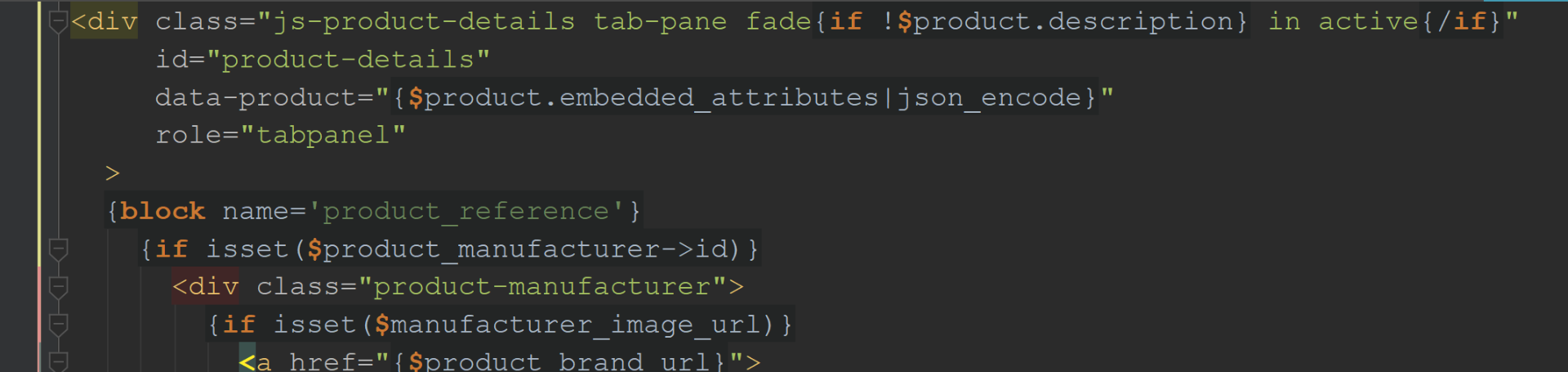

the code below from the classic theme
<div class="js-product-details tab-pane fade{if !$product.description} in active{/if}"
     id="product-details"
     data-product="{$product.embedded_attributes|json_encode}"
     role="tabpanel"
it is replaced by
<div {if isset($SP_moreinfo) && $SP_moreinfo == 'tab'} class="tab-pane {if !$product.description} in active{/if}"  {/if} id="product-details">
should I add the missing code below to my theme's product-details file ?
     role="tabpanel"
