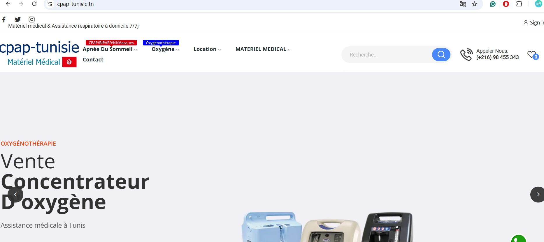

Momo159 Posted December 20, 2024 Share Posted December 20, 2024 i have in defines.inc.php in /config/ define('_PS_MODE_DEV_', true); I get a white screen, nothing in HTML, but in backoffice admin, the debug is working. I am using Elementor likely page constructor, so what must I dot in my website https://www.cpap-tunisie.tn/ Link to comment Share on other sites More sharing options...
Momo159 Posted December 20, 2024 Share Posted December 20, 2024 under Chrome browser i get : L'accès à www.cpap-tunisie.tn a été refusé Vous n'êtes pas autorisé à consulter cette page. HTTP ERROR 403 So why debug mode make an error 403 :! Link to comment Share on other sites More sharing options...
ST-THEMES Posted December 23, 2024 Share Posted December 23, 2024 Hi, It seems I can access the site via chrome. Best regards. Link to comment Share on other sites More sharing options...
