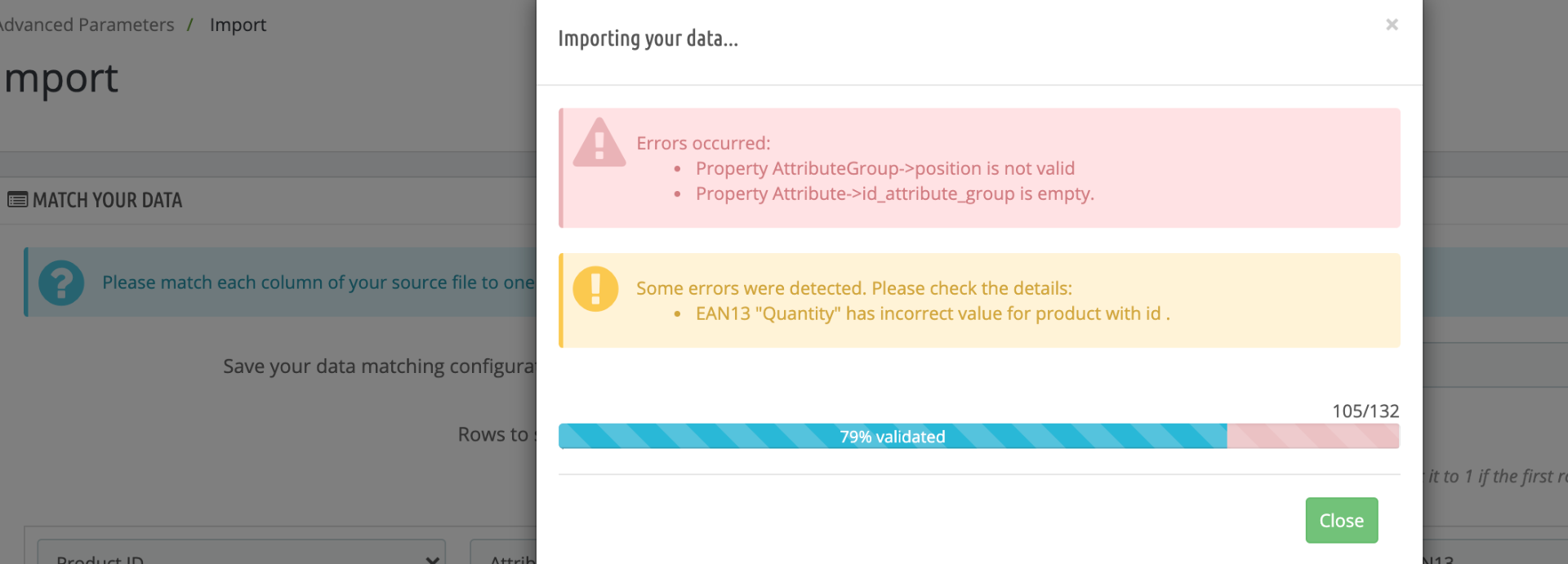

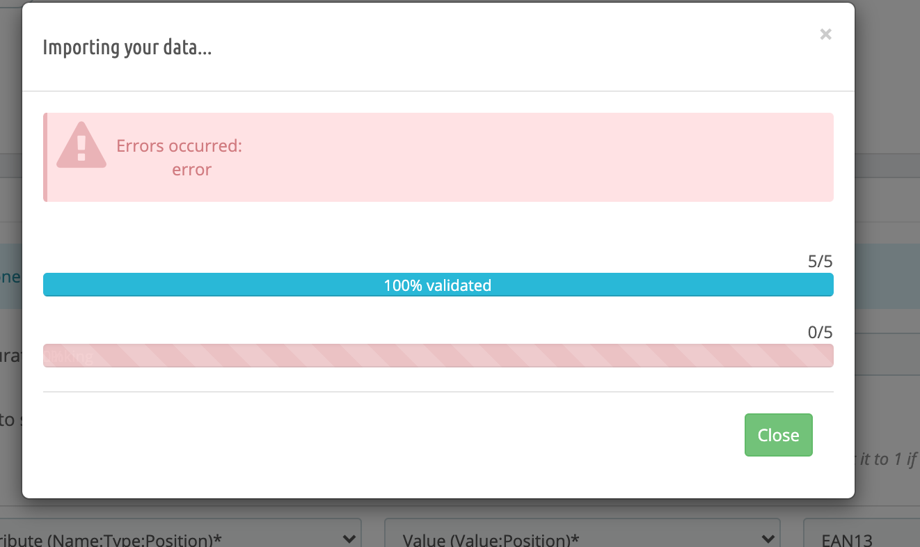

plutocrata Posted October 5, 2021 Share Posted October 5, 2021 Guys, really struggling here to import combinations... been checking all possible topics here, could not make it work. At all!!!! Either using csv, xml, there's always an error. Using a test csv. Link to comment Share on other sites More sharing options...
plutocrata Posted October 5, 2021 Author Share Posted October 5, 2021 Just now, plutocrata said: Using a xls Link to comment Share on other sites More sharing options...

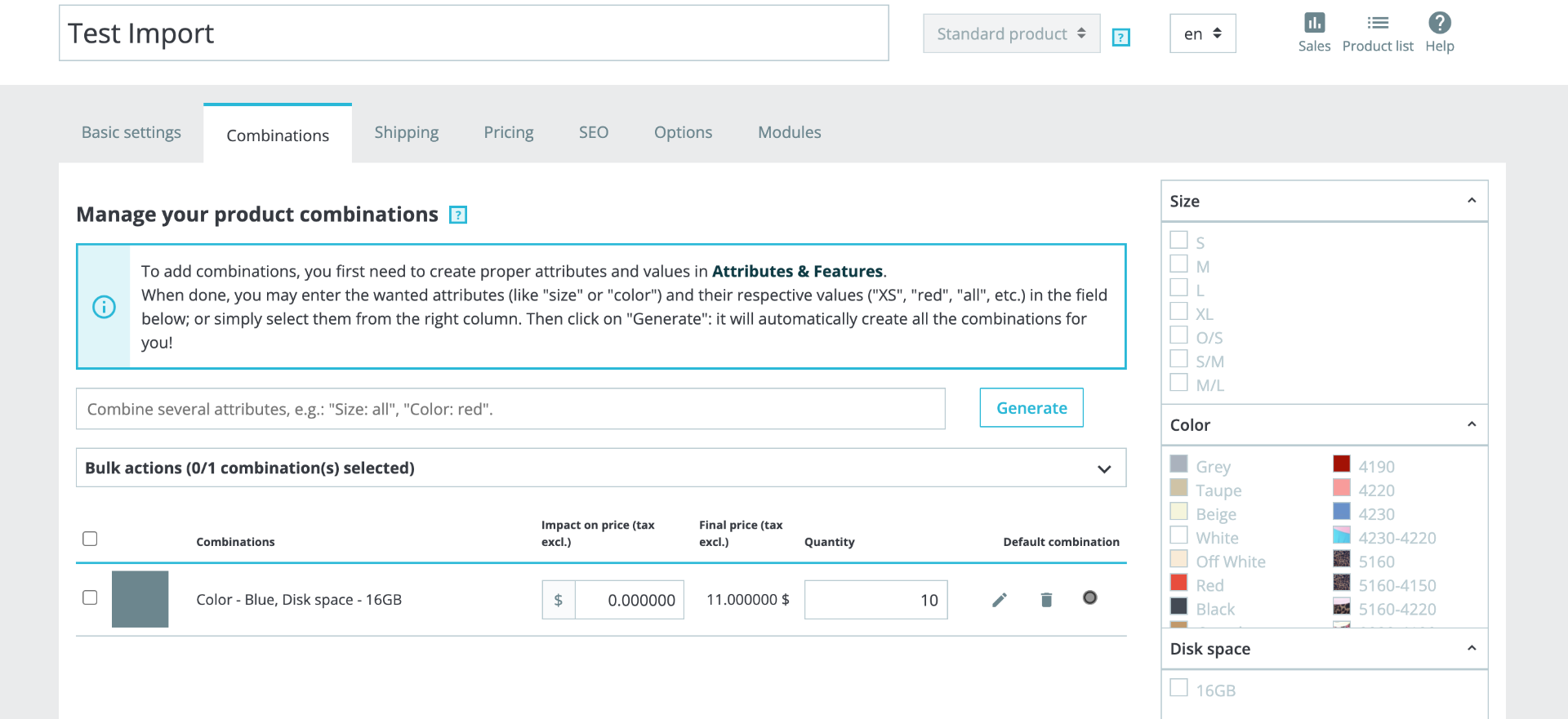

plutocrata Posted October 5, 2021 Author Share Posted October 5, 2021 Even importing the own sample file from prestashop in a test product gives me same error. Only import the very first combination, just one line. Any idea? Link to comment Share on other sites More sharing options...
plutocrata Posted October 6, 2021 Author Share Posted October 6, 2021 Nobody can help? Thanks in advance! Link to comment Share on other sites More sharing options...

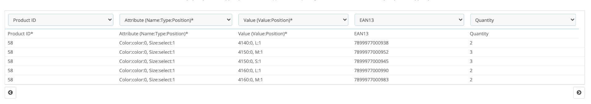

plutocrata Posted October 14, 2021 Author Share Posted October 14, 2021 Sure... On 10/10/2021 at 7:56 PM, Aldeag said: can you attach the file? importar99csv.csv Link to comment Share on other sites More sharing options...
Aldeag Posted October 14, 2021 Share Posted October 14, 2021 I don´t find anything wrong in that file. Check the error message. Maybe it takes the name of the color (a number, as I see) as an ID of the color, that may not exist, instead of it´s name. Make a backup of your database, change the numbers of the colors for a name (red, blue) and upload again. They should be created even if they don´t already exist. Saludos desde España. Link to comment Share on other sites More sharing options...
Aldeag Posted October 14, 2021 Share Posted October 14, 2021 Have you uploaded, first, the products with that ID, and after that, the combinations? Link to comment Share on other sites More sharing options...
justmeagain Posted October 25, 2021 Share Posted October 25, 2021 It tells you that Property AttributeGroup>position is not valid I've attached a working version of one of mine with highlighted parts - try adjusting your values to similar and see what happens Also worth noting (I know you not using colours but codes but might be worth investigating) - You have to spell color the American (incorrect) way, otherwise prestashop doesn't pick up the off-the-shelf Color Attributes. You could create your own Product Attributes called Colour and define each colour yourself, but it makes sense to pick up the existing ones. importar99csv.csv Link to comment Share on other sites More sharing options...
Aldeag Posted October 30, 2021 Share Posted October 30, 2021 (edited) If you add a color that does not exist, Prestashop creates the new color. If you have Pink but you import Pink Gradient, Prestashop creates that new one. Also if you have Pink but you import PINK, Prestashop creates new color PINK. So I don´t understand why it does not create a color called "4140" unless it does not accept numbers or the Attribute "Color" (not their Values) does not exist. Check the spelling maybe Prestashop calls "Colour" and you call it "Color" and that will give you an error, because you need to have the Attribute before it´s values. Please, advise. Edited October 30, 2021 by Aldeag (see edit history) Link to comment Share on other sites More sharing options...

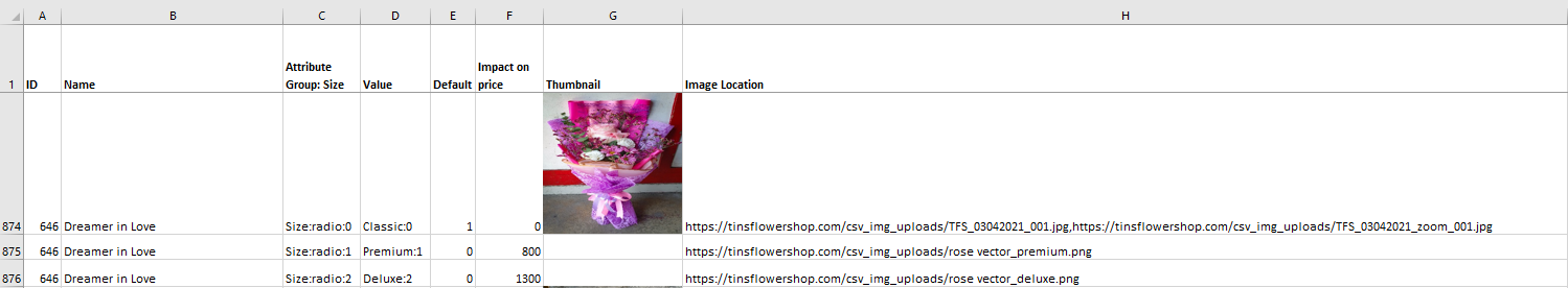

flowers_ph Posted November 4, 2021 Share Posted November 4, 2021 (edited) this is how i do mine - might help? I have my product details on one sheet and the combination on a separate sheet in excel - then output to csv and upload heres a script for adding photos to excel https://www.extendoffice.com/documents/excel/1156-excel-insert-multiple-pictures.html#a1 Edited November 4, 2021 by bnadauld (see edit history) Link to comment Share on other sites More sharing options...
Kogkalidis Posted July 28, 2022 Share Posted July 28, 2022 (edited) On 10/6/2021 at 4:06 PM, plutocrata said: Nobody can help? Thanks in advance! You have for example this record. Why you have position as well? And in color I think you should have Name instead of attribute_id. Edited July 28, 2022 by Kogkalidis (see edit history) Link to comment Share on other sites More sharing options...
