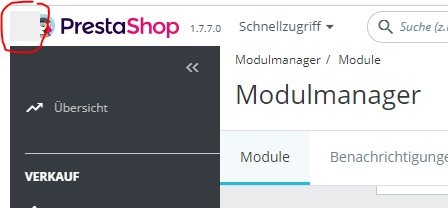

I have a copy from my production environment for testing upgrades. Once, i have upgraded my test-shop to version 1.7.7.5 i noticed, that i can't use my modul manager. I can't install a modul or connect to to market place, the buttons seams to be inactive. Also the modul search bar does not work. Additional, modul update messages will also not displayed.

I ignored this information an logon to my backend and see, the result is the same. So, in my opinion it must be an issue with version 1.7.7.0 on my site.  On the Modul-Manager-Site I have noticed that the "spinner" does not load. The Web Console reports th follwing error:
default.js?1.7.7.0:7 Uncaught TypeError: $(...).tooltip is not a function

Hi @ll,
after a long analysing and testing i found out, it was an jquery conflict. Newer version of prestshop comes with jquery per default. The issue was, in my theme, the jquery was pushed im some sections of my BO. I comment out the lines where the jquery will pushed, this solve my issue.
