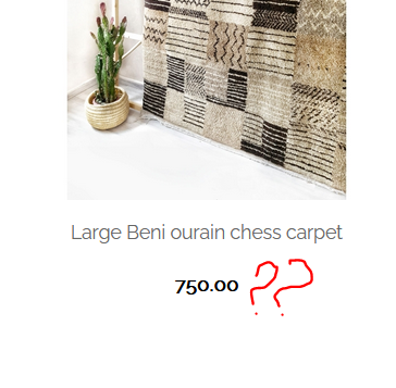

norman_12 Posted July 8, 2021 Share Posted July 8, 2021 (edited) Hi Guys need some help please! i have added a new currecy "MAD" and set it as a default, the issue is the MAD symbol does not appeard in the front office i even checked this path /localization/CLDR/core/common/main/ and selected ar_MA.xml but didn't find the <currencyFormats> tag in order to change the symble manually any ideas ? im using Prestashop 1.7.6.5 Looking forward to hear your thoughts guys Edited July 14, 2021 by norman_12 (see edit history) Link to comment Share on other sites More sharing options...

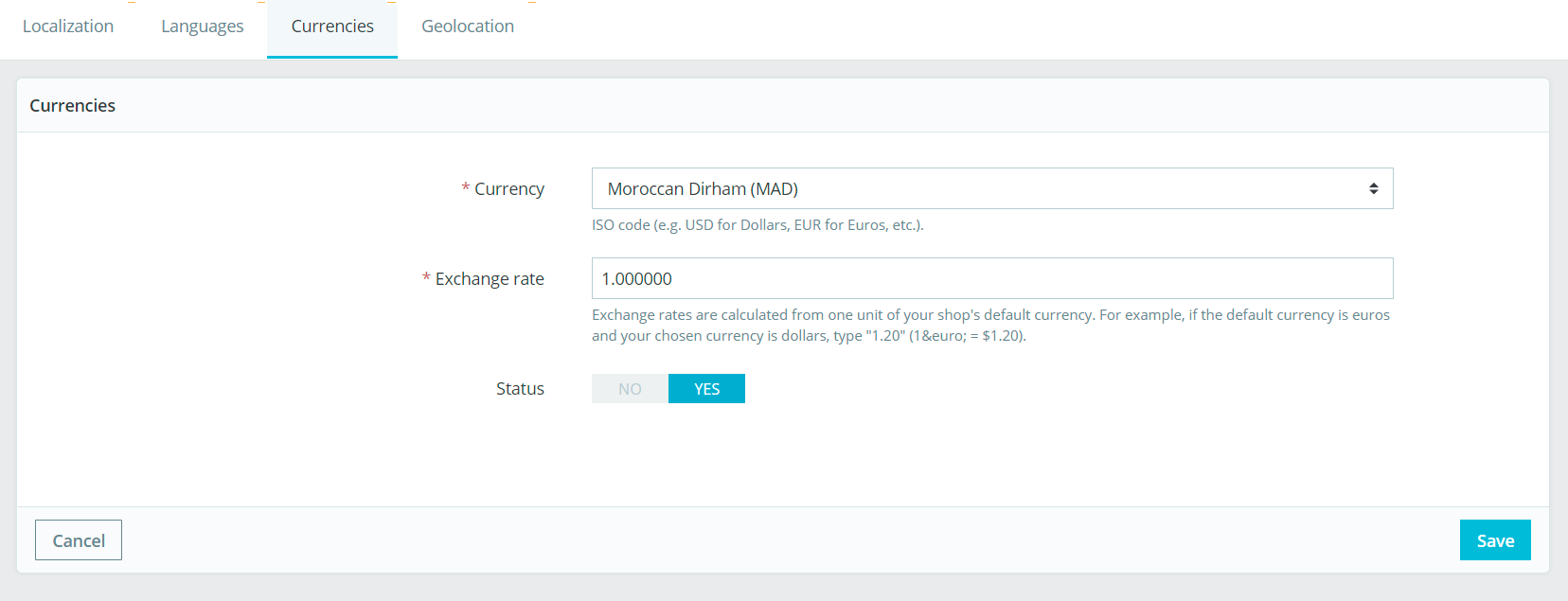

norman_12 Posted July 8, 2021 Author Share Posted July 8, 2021 @Crezzur Thanks for the reply i don't have those settings the only settings i have are the one in the shared picture " Currency " and " Exchange rate " i believe these settings such as " ISO code " and " Decimals " are no longer available in 1.7.6.5 and higher Link to comment Share on other sites More sharing options...
