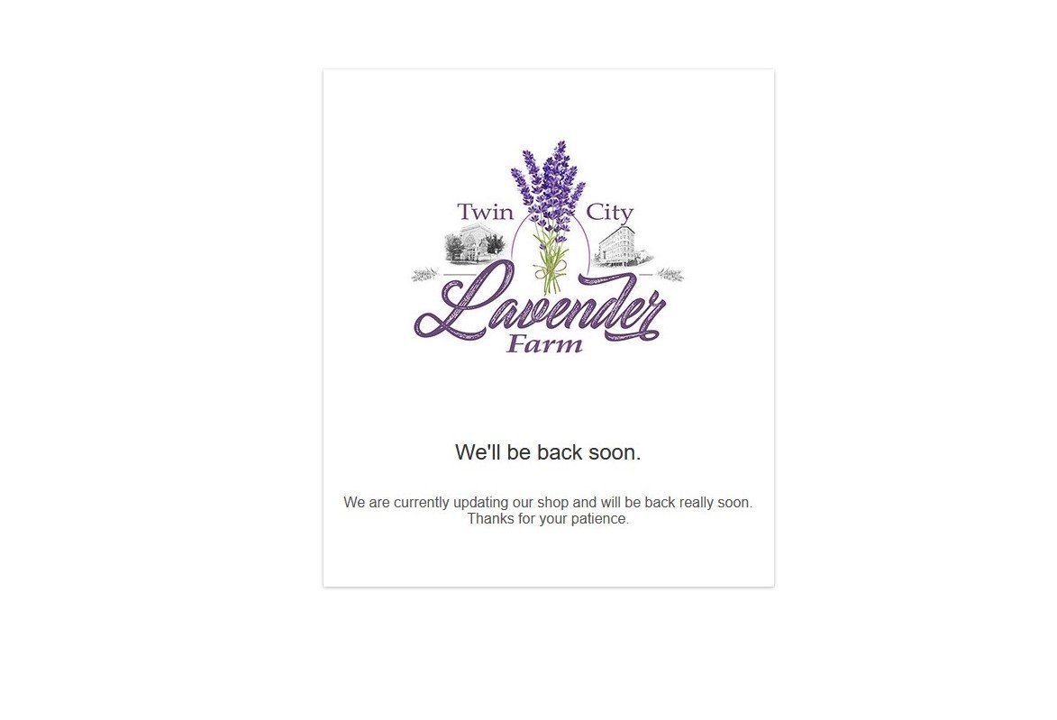

andersonj10 Posted June 28, 2021 Share Posted June 28, 2021 After my update failed I restored the host files and the db. The outward-facing site still shows " We'll be back soon. We are currently updating our shop and will be back really soon. Thanks for your patience.". When I log in as admin I get no errors but I go to the same display. How do I get the site out of maintenance here are some thing I have tried; UPDATE variable SET value = 'i:0;' WHERE name= 'maintenance_mode'; DELETE FROM cache_bootstrap WHERE cid = 'variables' MySQL said: Documentation #1146 - Table 'httptwin_tcl.cache_bootstrap' doesn't exist UPDATE variable SET value = 's:1:"0";' WHERE name= 'maintenance_mode' MySQL said: Documentation #1146 - Table 'httptwin_tcl.variable' doesn't exist I can't find the variable that is being used to store the maintenance_mode value. Link to comment Share on other sites More sharing options...

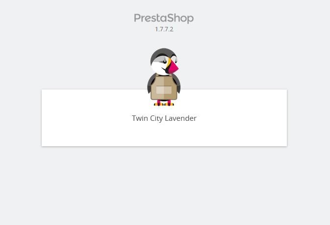

andersonj10 Posted June 28, 2021 Author Share Posted June 28, 2021 When I log in as administrator it takes me to this page. I can never get to the admin area. Link to comment Share on other sites More sharing options...
musicmaster Posted June 28, 2021 Share Posted June 28, 2021 20 hours ago, andersonj10 said: After my update failed I restored the host files and the db. The outward-facing site still shows " We'll be back soon. We are currently updating our shop and will be back really soon. Thanks for your patience.". When I log in as admin I get no errors but I go to the same display. How do I get the site out of maintenance here are some thing I have tried; UPDATE variable SET value = 'i:0;' WHERE name= 'maintenance_mode'; DELETE FROM cache_bootstrap WHERE cid = 'variables' MySQL said: Documentation #1146 - Table 'httptwin_tcl.cache_bootstrap' doesn't exist UPDATE variable SET value = 's:1:"0";' WHERE name= 'maintenance_mode' MySQL said: Documentation #1146 - Table 'httptwin_tcl.variable' doesn't exist I can't find the variable that is being used to store the maintenance_mode value. This puzzles me. It doesn't even come close. Try the ps_configuration table and look for "PS_SHOP_ENABLE" Link to comment Share on other sites More sharing options...

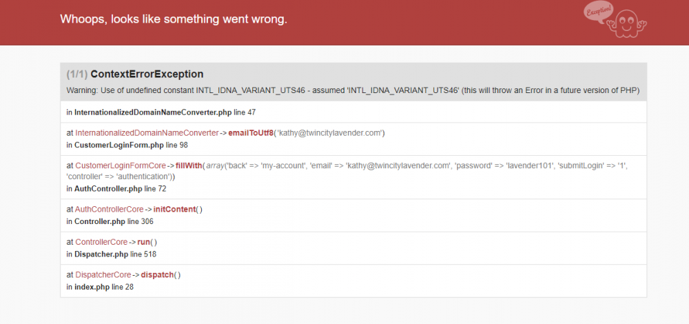

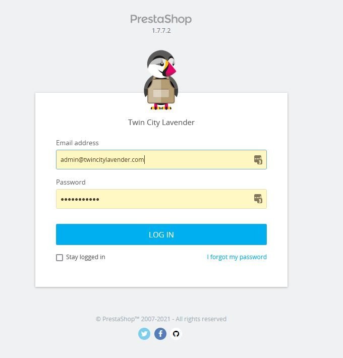

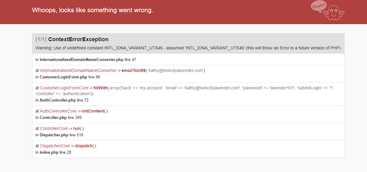

andersonj10 Posted June 29, 2021 Author Share Posted June 29, 2021 Thanks. I changed the PS_SHOP_ENABLE value to 1 and I get in farther. I still can't get to the admin area. The database does not have a USER table. I can not log into the site. When I try to log into the dashboard, This is as fare as I go Link to comment Share on other sites More sharing options...
musicmaster Posted June 29, 2021 Share Posted June 29, 2021 INTL_IDNA_VARIANT has something to do with your ICU version. See https://github.com/PrestaShop/PrestaShop/pull/11995 Link to comment Share on other sites More sharing options...
