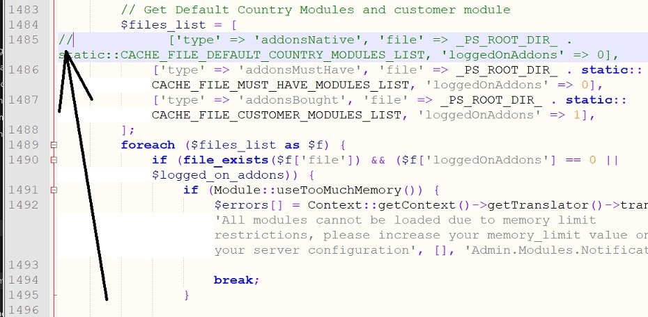

logosur Posted May 19, 2021 Author Share Posted May 19, 2021 sorry now it loads the module but throws and unknown error, and I can see this at logs: 2021-05-19 13:39:22] php.DEBUG: Warning: file_get_contents(/home/.../public_html/config/xml/default_country_modules_list.xml): failed to open stream: No such file or directory [] [] Link to comment Share on other sites More sharing options...
musicmaster Posted May 19, 2021 Share Posted May 19, 2021 I have no idea what the cause can be. You can try to solve it by outcommenting line 1485 of /classes/module/Module.php Link to comment Share on other sites More sharing options...
