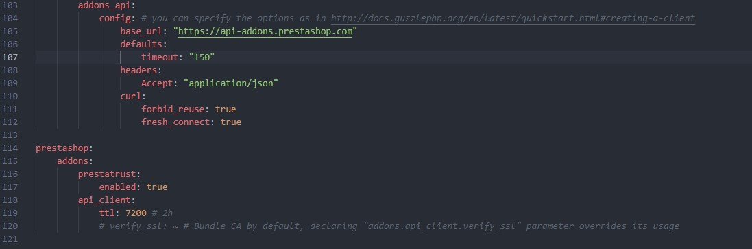

Gengai Posted October 29, 2021 Share Posted October 29, 2021 (edited) Hi, I encountered same problem when i tried to connect to prestashop marketplace, first message was like I should check my internet connection, on debug mode i got something like Data from PrestaShop Addons is invalid, and cannot fallback on cache , i tought that allow_url_fopen is disabled but that was not case. So I figured out maybe there is something with timeout, so i went to /app/config.yml and on line 107 there is timeout set to 5.0 I guess that is 5 seconds. I changed it to 150 as you can see on attachment and it was working after that just fine. So what was causing this ? I think that in may server needs more time to proces request and give back response if it's not in 5 secons it will throw an error. My prestashop version is 1.7.8.0 I hope this will help someone. Cheers Edited October 29, 2021 by Gengai (see edit history) 1 1 Link to comment Share on other sites More sharing options...

photoinvest Posted January 15, 2022 Share Posted January 15, 2022 On 10/29/2021 at 3:43 PM, Gengai said: Hi, I encountered same problem when i tried to connect to prestashop marketplace, first message was like I should check my internet connection, on debug mode i got something like Data from PrestaShop Addons is invalid, and cannot fallback on cache , i tought that allow_url_fopen is disabled but that was not case. So I figured out maybe there is something with timeout, so i went to /app/config.yml and on line 107 there is timeout set to 5.0 I guess that is 5 seconds. I changed it to 150 as you can see on attachment and it was working after that just fine. So what was causing this ? I think that in may server needs more time to proces request and give back response if it's not in 5 secons it will throw an error. My prestashop version is 1.7.8.0 I hope this will help someone. Cheers THANK YOU!!!!!!!!! 🙏 I tried so many things and couldn't find any solution. And it was just a freaking "timeout". Link to comment Share on other sites More sharing options...
shaynes Posted May 6, 2022 Share Posted May 6, 2022 Great troubleshooting @Gengai! This worked for me as well. Thank you! So, @Prestashop Admin please implement this fix if possible, I set the timeout at 30 and it worked as well. Thank you. Link to comment Share on other sites More sharing options...
