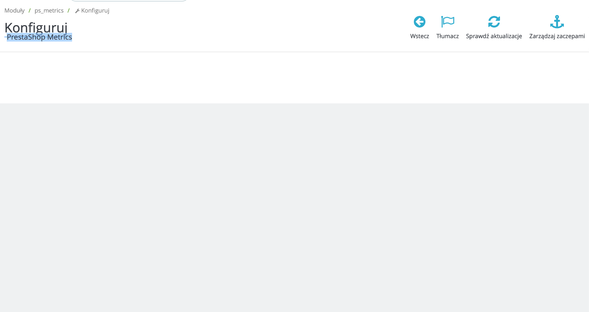

I couldn't update PrestaShop Metrics to the new version (I kept getting an error that the update couldn't be performed). So I decided to delete the old version and reinstall.
Unfortunately after reinstalling the module I got an empty configuration page.
103348920_Zrzutekranu2021-02-15o10_05_24.thumb.png.cf952e865d7c50db32cef266baf79811.png
Hi,
try to enable the debug mode and then check the module's configuration page to see the error which is causing the empty page, if it's still not working, try resetting the module while debug mode is turned on, to check if there are some errors/warnings when resetting the module. If still not working, try uninstalling and reinstalling the module.
Kind regards, Leo
