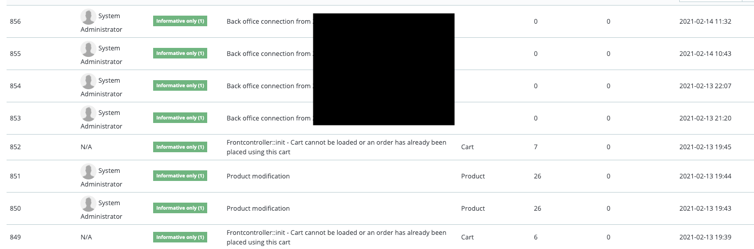

The logs are showing nothing:

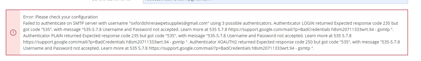

@Glen MacPherson I am struggling with this so much. I have pretty much everything else sorted but cannot get outgoing emails to work at all. I tried to set it up with my ionos hosted domain email but that wouldn't work at all and then tried to set up with Gmail account but it still returns an error when generating the test email. Can anyone help at all?
Thank you Glen for responding, this is the first thing I havent been able to get a solution for everything else i have managed to sort along the way (I am no web developer just picking it up as I go)
When I enter the details I get the following message. I have checked and rechecked and even changed the password in case I was getting it wrong but I know its good. I have also tried the TLS setting but that didnt work either.
I am wondering if you have to have gmail workplace set up as I think this is just set up as a general personal gmail account. Any help is greatly appreciated.
