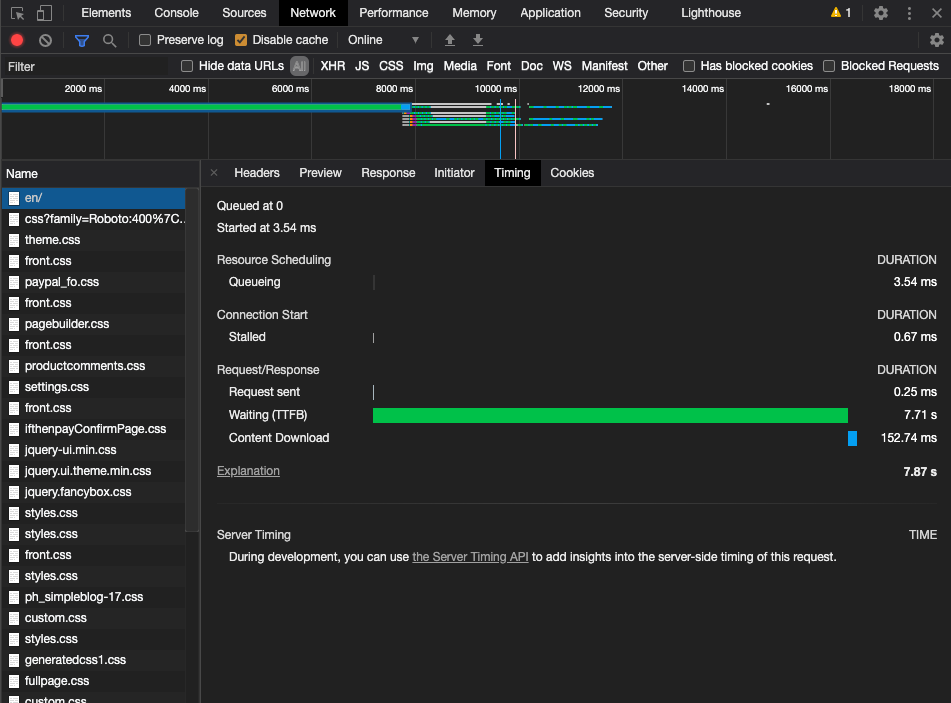

alvesjc Posted January 14, 2021 Share Posted January 14, 2021 Hello. Store with 13k products, and it's taking a very long time to load homepage. with profiling I get the values in attachment. The problem is with initcontent and display. I've found a reference here about translations, but tried with all languages and all are the same. How can I further debug and improve this? Help appreciated. Link to comment Share on other sites More sharing options...

alvesjc Posted January 14, 2021 Author Share Posted January 14, 2021 (edited) The timings shown on browser are very bad also. TTFB should be less then 500ms Edited January 14, 2021 by alvesjc Wrong image (see edit history) Link to comment Share on other sites More sharing options...

alvesjc Posted January 17, 2021 Author Share Posted January 17, 2021 Hi again. For caching I only use opcache, but I've it disabled now. Meanwhile tried a few things. Upgraded to 1.7.7.1 and no change on behaviour. So, I moved to the default team to make sure that wasn't the theme and come to conclusion that with default team the page loads around 500ms. So this poor performance on homepage looks like to be the Alysum theme causing it. But since I only ordered for 3 months support, can't talk with them anymore. But I've other issue now with 1.7.7.1, the checkout process hangs or is very very slow after entering address. I've seen that there is an issue with very big cart's, but I'm testing with only one product. Regarding the theme, with 1.6 I was able to set the theme the way I want customizing the files. With 1.7 I can't do this easily. What tools do I need to edit the prestashop default theme? Can you advise on this? I want to stop use third party themes and get back to the customized default theme. Since I've decided to go to third party theme, all I had was problems. Thanks Link to comment Share on other sites More sharing options...
