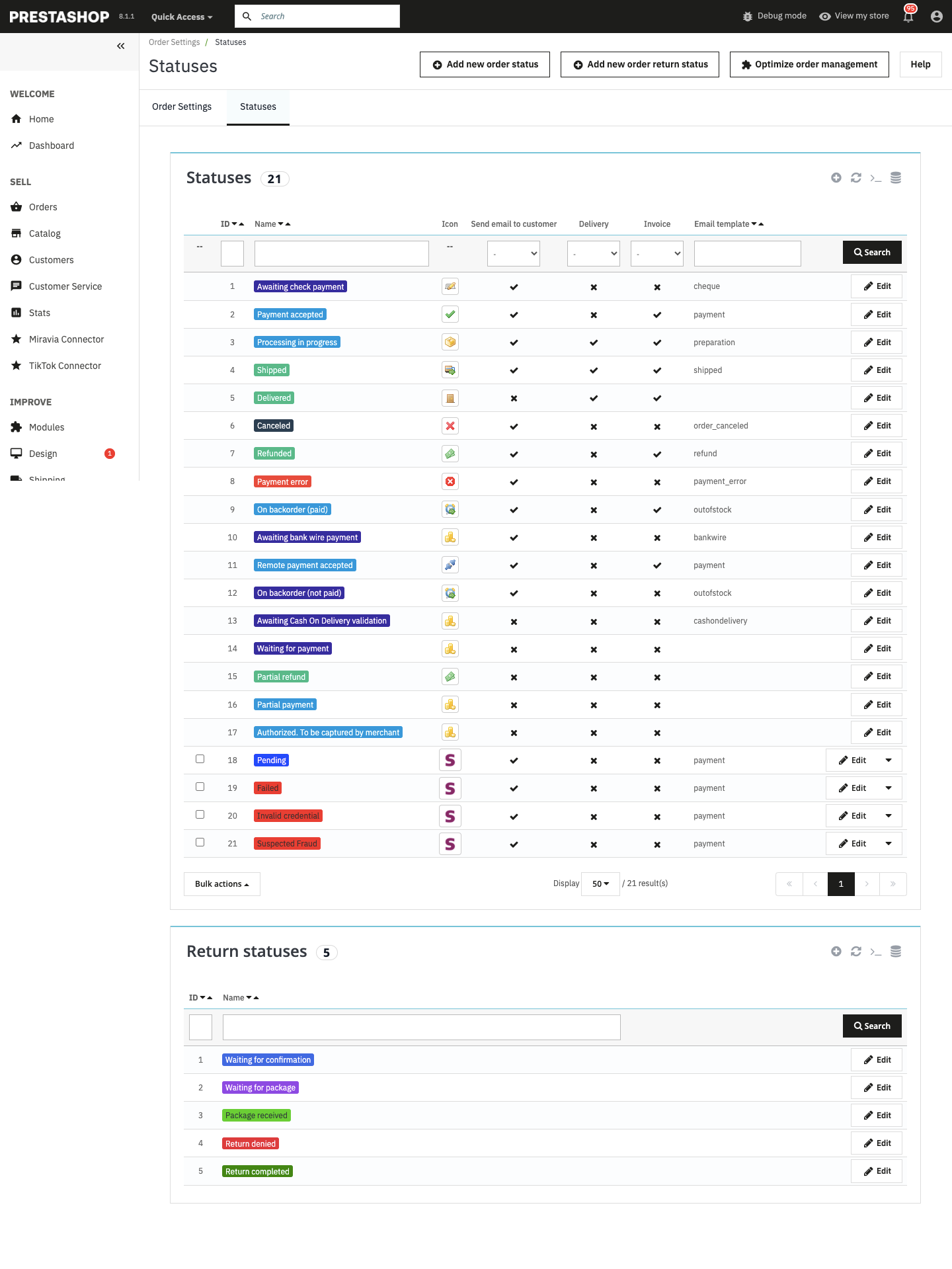

Villaing Posted May 26, 2020 Author Share Posted May 26, 2020 It simply seems the webservice just ignores the current_state variable for new orders. For now, I simply changed the order of the current states (since it always takes the last one in the list) so it will take a custom "Webservice pending" state. After the order is created I update it with the correct state. This is definitely not a nice way to do it, but for now my only solutions. In my eyes this still seems like a malfunction in PrestaShop's webservice, or a case of bad documentation! I hope this will be "fixed" in the future.. Link to comment Share on other sites More sharing options...

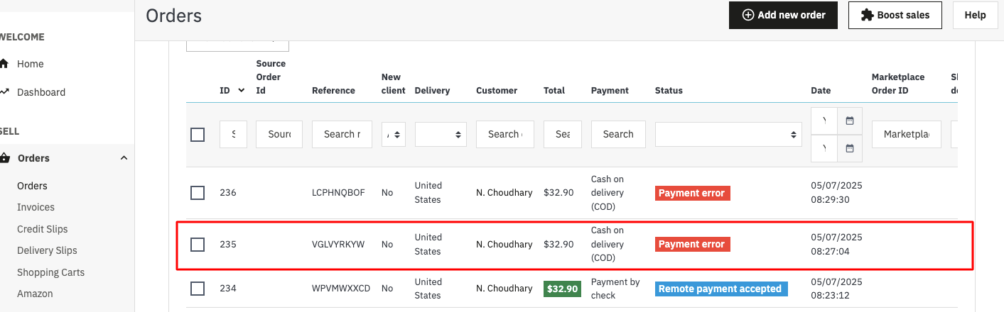

Namrata13 Posted May 7, 2025 Share Posted May 7, 2025 Hello @here Anyone find any solution for above. I am also getting same error "payment error" while creating order via webservice api. Order creation setting its own order status its not taking which I am sending via api Order request body- <?xml version="1.0" encoding="UTF-8"?> <prestashop xmlns:xlink="http://www.w3.org/1999/xlink"> <order> <id_address_delivery>7</id_address_delivery> <id_address_invoice>7</id_address_invoice> <id_cart>384</id_cart> <id_currency>1</id_currency> <id_lang>1</id_lang> <id_customer>3</id_customer> <id_carrier>3</id_carrier> <current_state>14</current_state> <!-- Must match an unpaid order state --> <module>ps_cashondelivery</module> <!-- Use actual folder name --> <payment>Cash on delivery (COD)</payment> <total_paid>0.00</total_paid> <total_paid_real>0.00</total_paid_real> <total_products>12.90</total_products> <total_products_wt>12.90</total_products_wt> <conversion_rate>1.00</conversion_rate> <reference>Test1234</reference> <associations> <order_rows> <order_row> <product_id>17</product_id> <product_attribute_id>0</product_attribute_id> <product_quantity>1</product_quantity> <product_price>12.90</product_price> <unit_price_tax_incl>12.90</unit_price_tax_incl> <unit_price_tax_excl>12.90</unit_price_tax_excl> </order_row> </order_rows> </associations> </order> Anyone please help me in that. Thank you </prestashop> Link to comment Share on other sites More sharing options...
