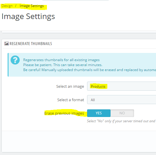

idnovate.com Posted April 17, 2020 Share Posted April 17, 2020 Regenerate images and remove the previous ones: Link to comment Share on other sites More sharing options...

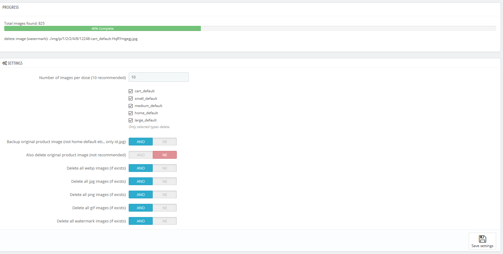

Guest Posted April 18, 2020 Share Posted April 18, 2020 I am finishing up a module that will run without restriction timeout. Link to comment Share on other sites More sharing options...
Digital360Europe Posted April 18, 2020 Author Share Posted April 18, 2020 Hello! I almost have done! I follow your instructions and I am almost there... You should have told me from the beginning to try it. Even in a trial version it would have saved me from many hours of coding.🥴 Now I am testing my module and seems that working...🙏 Link to comment Share on other sites More sharing options...
