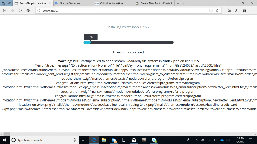

Mircea Zaharia Posted January 6, 2020 Share Posted January 6, 2020 Hello, I'm new and not an expert.... I try to install Prestashop 1.7.6.2 and at 8% installation stop and display this message :Â An error has occured: Warning: PHP Startup: failed to open stream: Read-only file system in /index.php on line 1315 {"error":true,"message":"Extraction error - No error","file":"bin\/symfony_requirements","numFiles":24082,"lastId":2500,"files": I don't know what to do. Please help me with some advice, Thanks Link to comment Share on other sites More sharing options...

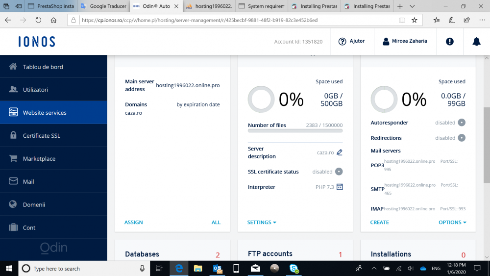

Mircea Zaharia Posted January 6, 2020 Author Share Posted January 6, 2020 It was 5.6. I changed to 7.2 but same error. Â Link to comment Share on other sites More sharing options...
Mircea Zaharia Posted January 6, 2020 Author Share Posted January 6, 2020 Link to comment Share on other sites More sharing options...

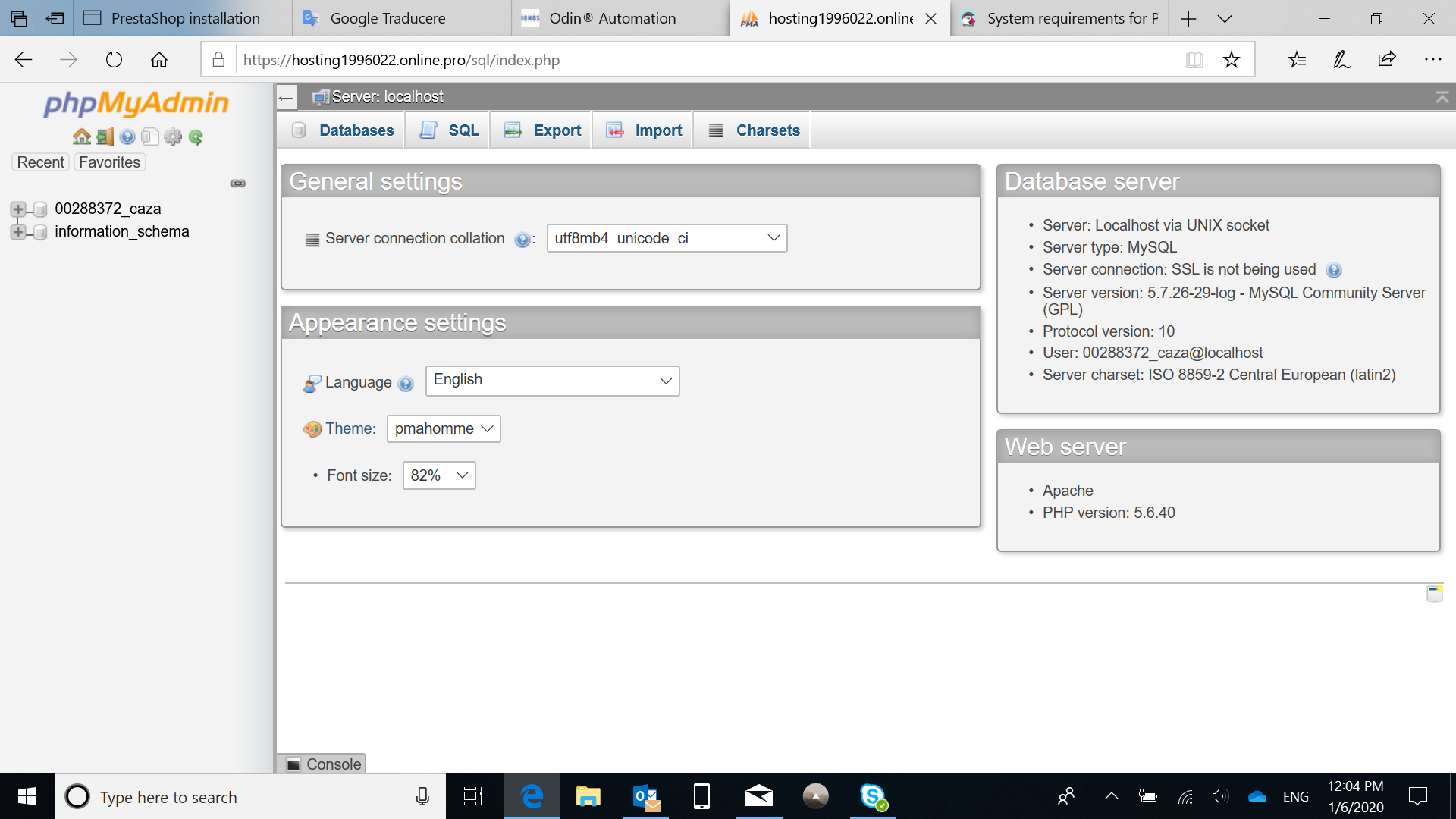

selectshop.at Posted January 6, 2020 Share Posted January 6, 2020 You didn't changed it. What I can see you are still on php version 5.6.40. Use cPAnel or Plesk admin panel for to change it. Or ask for support of your provider. BTW you are on wrong collation as well. For Prestashop 1.7. you need to have your database collation set to utf8_general ci. instead of unicode change it to utf8mb4_GENERAL_ci Link to comment Share on other sites More sharing options...
Mircea Zaharia Posted January 6, 2020 Author Share Posted January 6, 2020 I changed in the dashboard... Do I have to wait for update ? Â Link to comment Share on other sites More sharing options...
selectshop.at Posted January 6, 2020 Share Posted January 6, 2020 Database collation you changed as well ? Some servers have a cache. In this case yes. If it is not applying, than ask provider for help. Link to comment Share on other sites More sharing options...
Mircea Zaharia Posted January 6, 2020 Author Share Posted January 6, 2020 I changed now the database collation but same error. I will wait a while for update. Link to comment Share on other sites More sharing options...

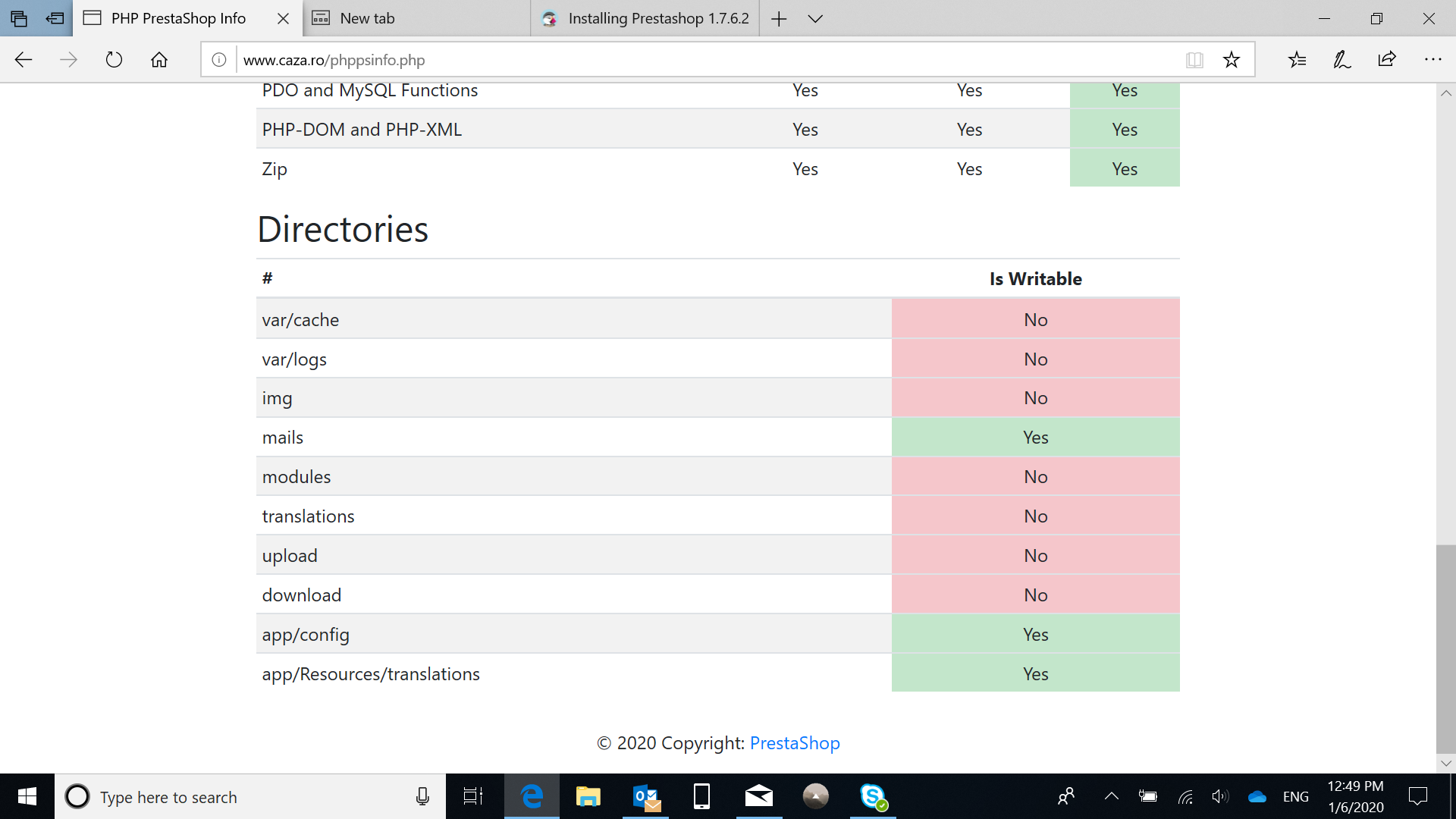

Mircea Zaharia Posted January 6, 2020 Author Share Posted January 6, 2020 I run diagnostic tool and I have a problem with folders... Link to comment Share on other sites More sharing options...
selectshop.at Posted January 6, 2020 Share Posted January 6, 2020 You need to give recursive rights to these folders. If you are not the server admin, then ask your provider for to change the rights on the server. Link to comment Share on other sites More sharing options...
