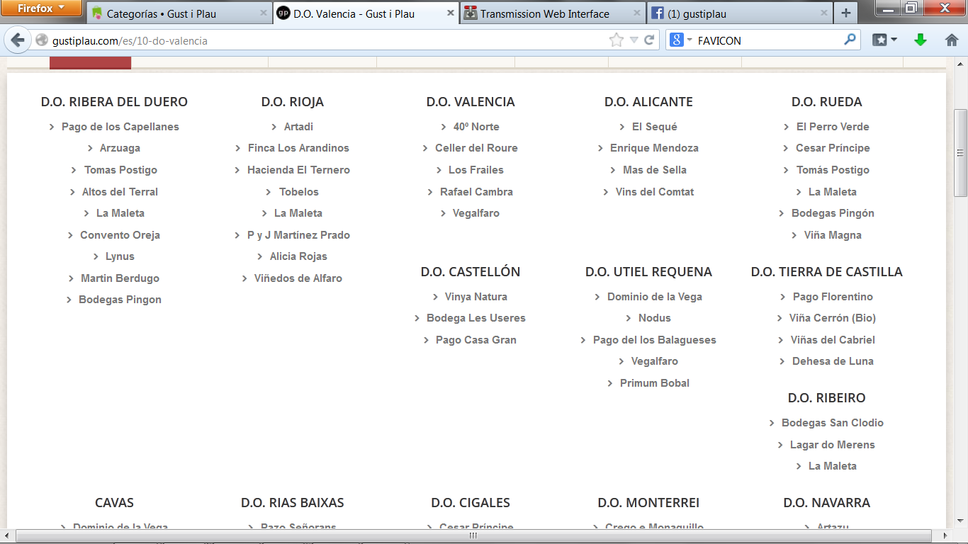

Thks vekia, but this problem only arise after solving the problem with missaligned subcategories removing
"clear:left" in
.sf-menu > li > ul > li.first-in-line-lg {
clear: left;
from
yourtheme/css/modules/blocktopmenu/css/superfish-modified.css
that is, if I left "clear:left" 2nd level subcategories are missaligned
if I remove "clear:left" 2nd level subcategories are aligned but 3rd level is messed up like in the attachhed image.
Is it possible to see this on a site. I never used 3rd level so i didn't know about this problem. But as vekia said this is some kind of bad menu styling
of course.
you can see it at
http://gustiplau.com
now "clear:left" is present in the css file and 2nd level subcategories are missaligned. you can see it in "Los Destilados" or "El condimento" options.

Hello,
If your only problem is in align, here you have it should help:
ul.sf-menu > li > ul li {
    text-align: center;
It will align center every single level of menu except first one
You're editing right file, but remeber if there have two css selectors with same strength last one will be used.
