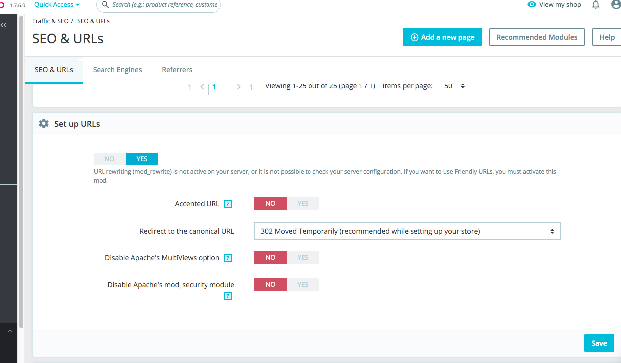

Finn Posted August 10, 2019 Share Posted August 10, 2019 Hi guys I am setting up a new website and just started creating products and the images are not showing on the front end. They are visible on the back end but there is just a blank white space with the caption where the image should be on the front end. In v 1.7.6.there is no option to disable friendly urls. As it was a new website, I thought it may of been a setting I changed accidentally or an external module that I uploaded. So I deleted it and reinstalled and Im having the exact same issue. Anyone else having this problem? Link to comment Share on other sites More sharing options...

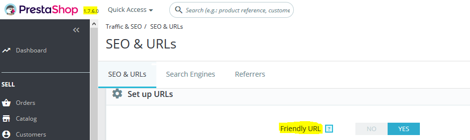

JBW Posted August 12, 2019 Share Posted August 12, 2019 On 8/10/2019 at 12:32 PM, Finn said: n v 1.7.6.there is no option to disable friendly urls. I think it's where it always was. Maybe try again: Link to comment Share on other sites More sharing options...
Finn Posted August 12, 2019 Author Share Posted August 12, 2019 1 hour ago, JBW said: I think it's where it always was. Maybe try again: I actually dont have that option-see below. I did disable the first option-the one that says..."URL rewriting (mod_rewrite) is not active on your server, or it is not possible to check your server configuration. If you want to use Friendly URLs, you must activate this mod". I disabled, cleared the cache, tested-same issue, enabled, cleared the cache-same issue. When that option was disabled I checked under the SEO option in my product and it did say the friendly urls are disabled. Your product images are showing okay? Link to comment Share on other sites More sharing options...
JBW Posted August 12, 2019 Share Posted August 12, 2019 15 minutes ago, Finn said: I actually dont have that option-see below. I did disable the first option-the one that says..."URL rewriting (mod_rewrite) is not active on your server, or it is not possible to check your server configuration. If you want to use Friendly URLs, you must activate this mod". So did you check if mod_rewrite is active on your server? Did it work in 1.7.5 for you? Link to comment Share on other sites More sharing options...

iakhan Posted April 10, 2020 Share Posted April 10, 2020 Hello all friends. I was also facing images not shown error in Prestashop 1.7.6.4 i read some articles and find the solution. please in the admin, under Settings>>> Traffic & SEO goto Setup URL and enable NO option there, it should look like red color NO. URL rewriting (mod_rewrite) is not active on your server, or it is not possible to check your server configuration. If you want to use Friendly URLs, you must activate this mod. then Save page and it will work fine. all product images are showing now. 1 Link to comment Share on other sites More sharing options...
