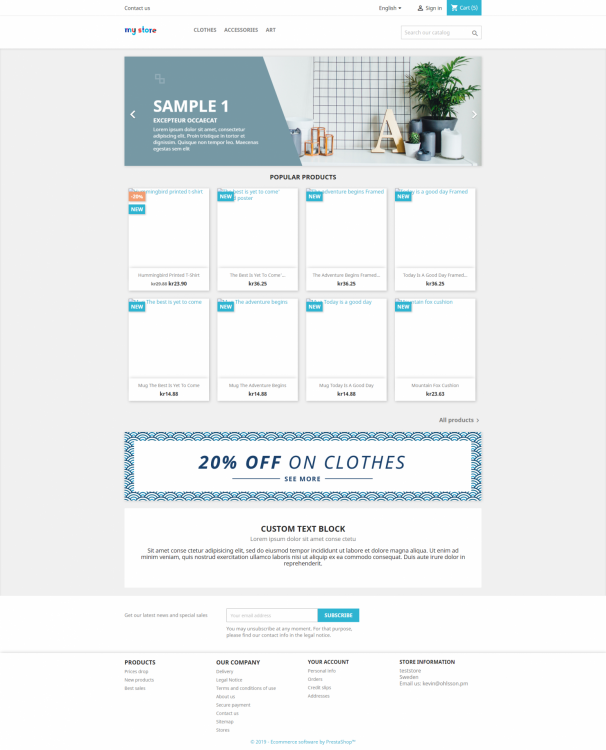

problem:
images not showing when firenndly URL is turned ON (SEE IMAGE BELOW)
IMAGES CAN BE SEEN FROM BACKOFFICE

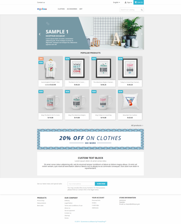

how can fix this?
more images:
debug image
PHP FILE
FRIENDLY URLS OFF
FRIENDLY URLS ON

debug image
PHP FILE
FRIENDLY URLS OFF
FRIENDLY URLS ON
