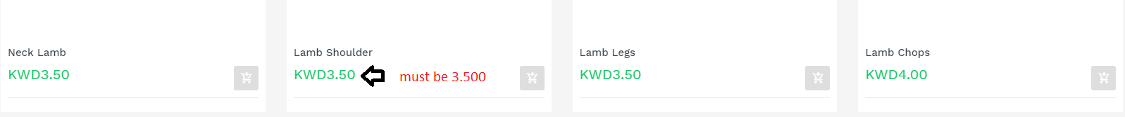

salem82 Posted March 22, 2020 Share Posted March 22, 2020 4 hours ago, Gerardo Martinez G said: put a screen where is your error, and version of prestashop The Kuwaiti dinar is sub-divided into 1,000 fils, so the price must displayed as follow: 1.540 this equal one dinar and 540 fils, in prestashop this showed as 1.54 We are working on the last version 1.7.6.4 and we tried to modify the xml files in 'root/localization/CLDR/core/common/main' with no effect. Link to comment Share on other sites More sharing options...

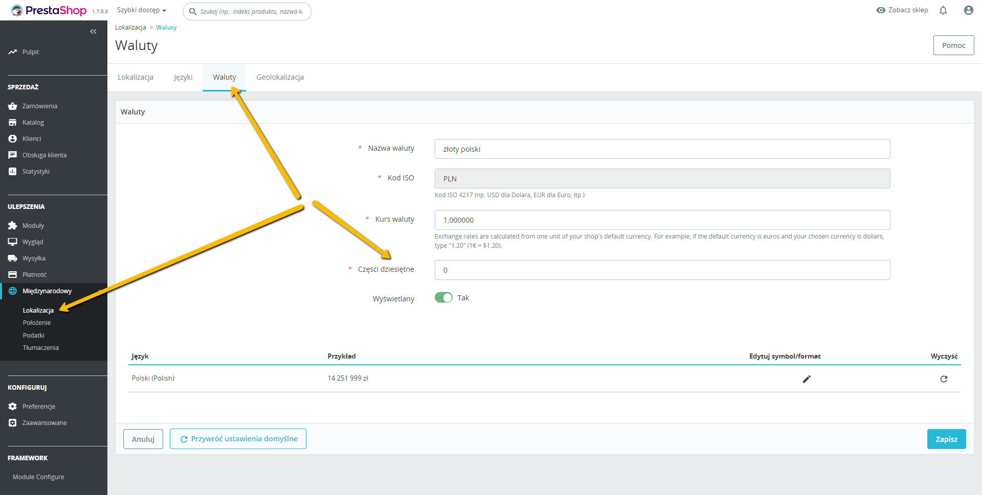

DorianS Posted March 30, 2023 Share Posted March 30, 2023 You just need to go to International --> Localization --> Currencies --> Edit your currency --> Set "decimal" to any number (can be 0) 1 Link to comment Share on other sites More sharing options...
pandorrah Posted April 11, 2023 Share Posted April 11, 2023 That did nót solved the case. These extra zero's are hardcoded in scripts, they are not solved by your suggestion. Link to comment Share on other sites More sharing options...
