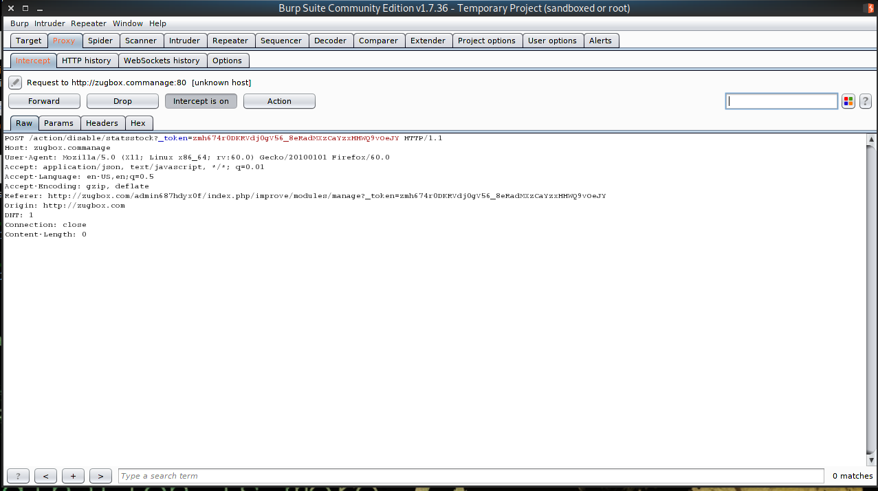

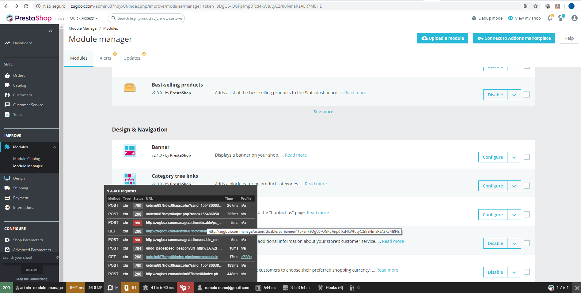

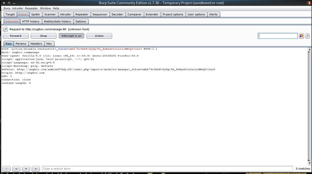

romulossp Posted April 10, 2019 Author Share Posted April 10, 2019 In debug mode I found this error (attached image), I think the POST request is not correct, does anyone know what I can do? How to fix this? = / Thx. Link to comment Share on other sites More sharing options...

Janett Posted April 10, 2019 Share Posted April 10, 2019 In your screenshot, the request as a missing / in url. http://zugbox.commanage/action/disable/ps_banner?_token=blabla instead of http://zugbox.com/manage/action/disable/ps_banner?_token=blabla Can you go in Advanced Parameters -> Information and take a screenshot ? 1 Link to comment Share on other sites More sharing options...
romulossp Posted April 10, 2019 Author Share Posted April 10, 2019 2 hours ago, Janett said: In your screenshot, the request as a missing / in url. http://zugbox.commanage/action/disable/ps_banner?_token=blabla instead of http://zugbox.com/manage/action/disable/ps_banner?_token=blabla Can you go in Advanced Parameters -> Information and take a screenshot ? Of course my friend .... Link to comment Share on other sites More sharing options...
romulossp Posted April 10, 2019 Author Share Posted April 10, 2019 if you want see the url format: Link to comment Share on other sites More sharing options...

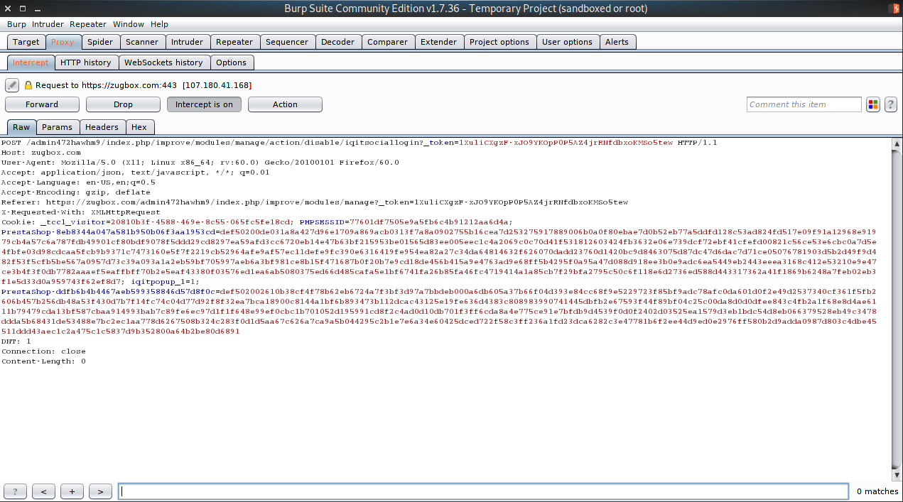

romulossp Posted April 10, 2019 Author Share Posted April 10, 2019 I see the possible problem ..... I intercepted the methods (old host and new) and saw this problem: (for some reason, prestashop is not completing the url ... which file is responsible for completing it? what can it be? Link to comment Share on other sites More sharing options...

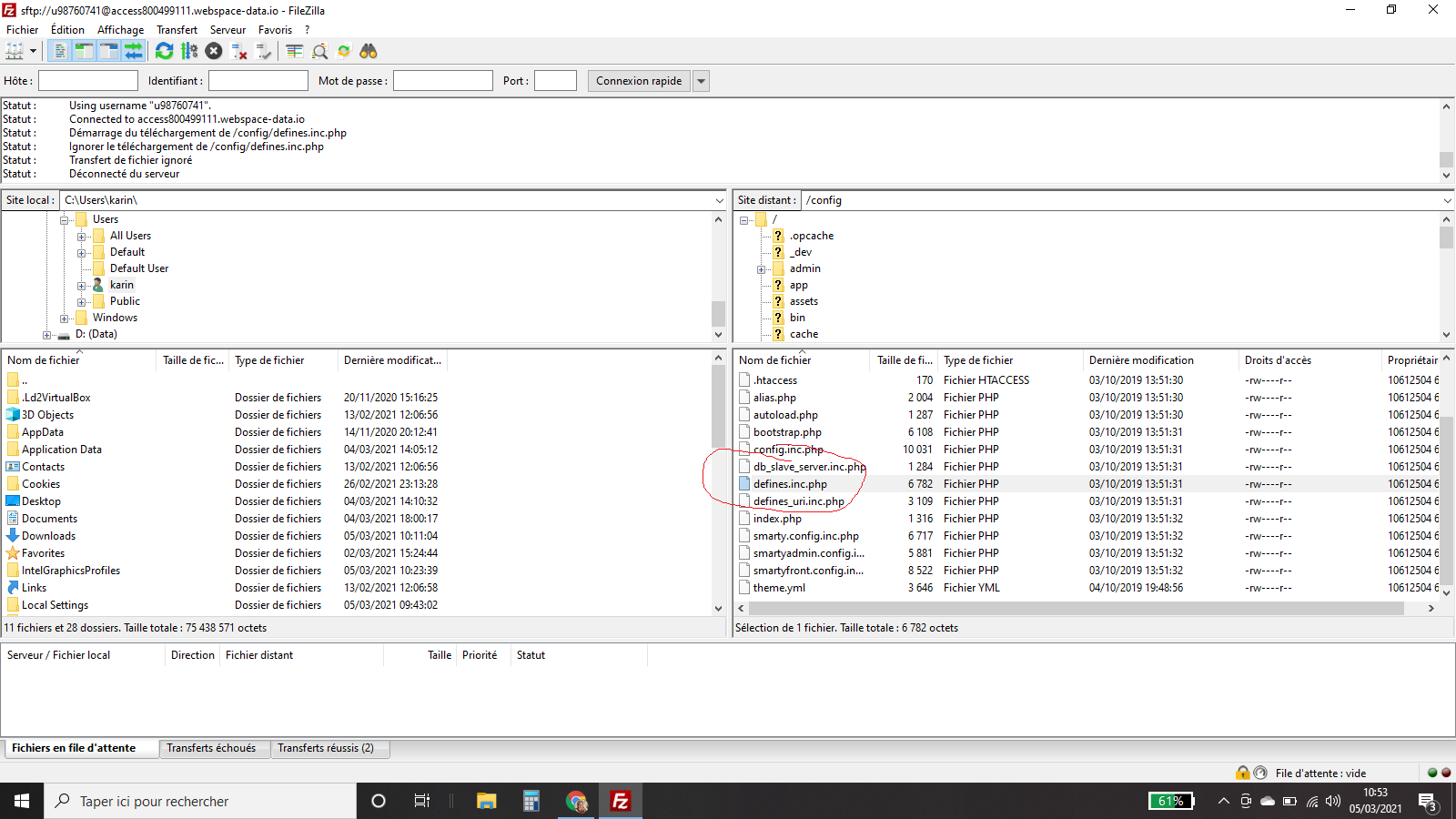

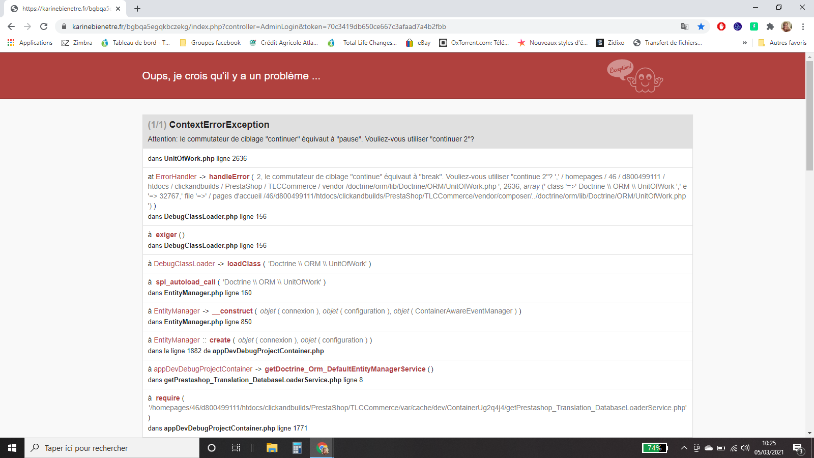

karine44130 Posted March 5, 2021 Share Posted March 5, 2021 bonjour, je suis embetée , je n'y connais rien et quand j'ai mis en mode debug voila ce que j'ai eu. le souci je ne peux plus revenir sur mon BO comment faire??? Link to comment Share on other sites More sharing options...
karine44130 Posted March 5, 2021 Share Posted March 5, 2021 j'ai trouvé ça Si vous n'avez pas accès au backoffice : Utilisez votre client FTP habituel pour ouvrir votre fichier /config/defines.inc.php sur votre serveur d'hébergement Dans ce fichier passez à ON l'option display_errors remplace define('_PS_MODE_DEV_', false); par define('_PS_MODE_DEV_', true); Enregistrez votre fichier sur votre serveur je trouve bien le fichier /config/defines.inc.php, mais pares comment j'ai accès à la suite, je ne vois pas??? merci de votre aide Link to comment Share on other sites More sharing options...

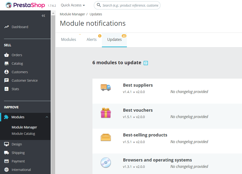

Andrejkov Posted June 2, 2022 Share Posted June 2, 2022 (edited) Hello, I have same problem but soulution from @eugenata doesnt work for me. When i try to update module i got error2.jpg, error3.jpg. When i try to install new module i got this error1.jpg (but in folder modules they are created new folder with module files but in backoffice is look like not installed). Can someone help me? ======================= Problem solved Edited June 5, 2022 by Andrejkov (see edit history) Link to comment Share on other sites More sharing options...
eugenata Posted June 2, 2022 Share Posted June 2, 2022 @Andrejkov try intall module out of debug mode Link to comment Share on other sites More sharing options...
Andrejkov Posted June 2, 2022 Share Posted June 2, 2022 (edited) On 6/2/2022 at 6:31 PM, eugenata said: @Andrejkov try intall module out of debug mode Problem solved. Edited June 5, 2022 by Andrejkov (see edit history) Link to comment Share on other sites More sharing options...
