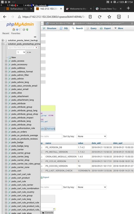

Using softaculous I accidentally kicked off the delete process for my prestashop installation.
About 2 seconds into the process I'd realised what I'd done and shut down the tab controlling the delete.
It looks like the codebase is stuffed but at first glance the database is ok.
I'm hoping to reinstall the codebase and just change the database in the config to the correct database not that that gets installed with the install.
Softaculous gives 3 options of different versions to download inc 1.7.51 and other versions lower than 1.7 but the database version. Is 1.7.4.2 what do you suggest I do?
