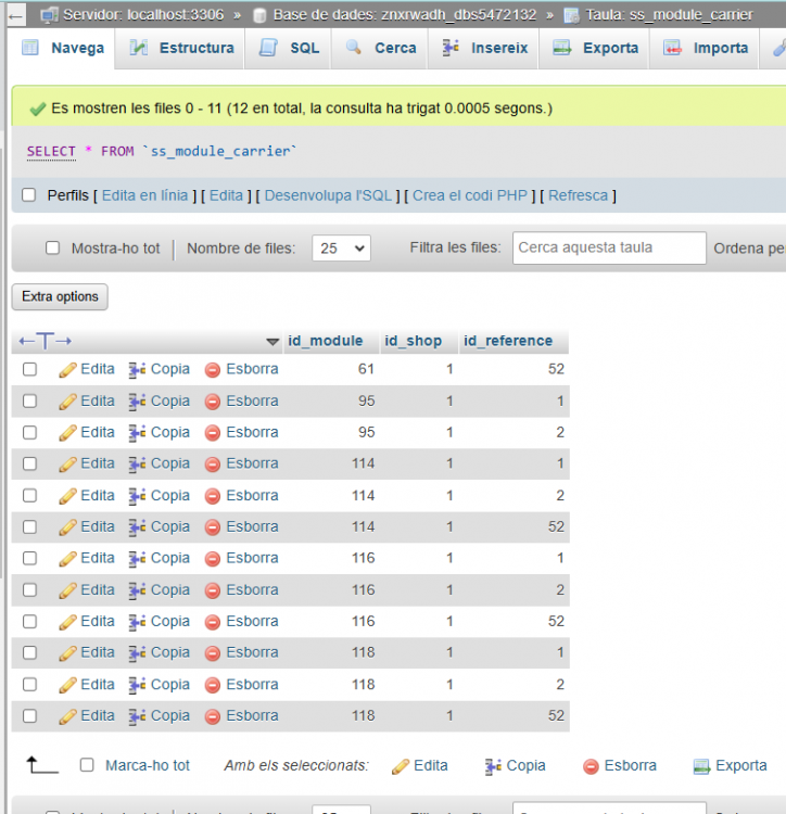

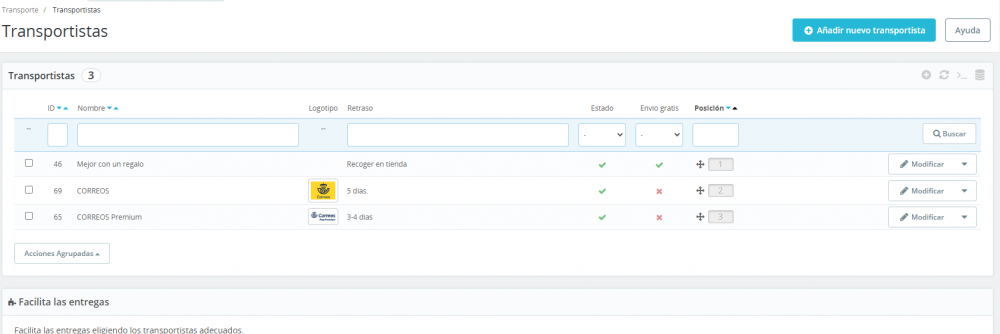

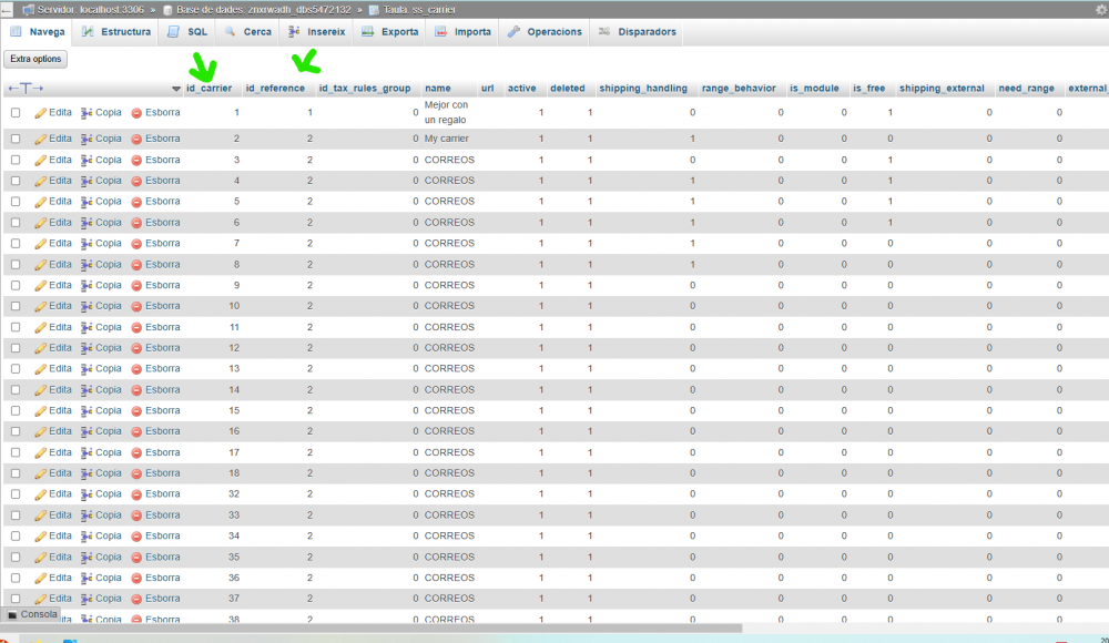

1- In the DB, under prefix_carrier there are ids 1 (pick up), and 2 (Correos), Many Correos rows due maybe to different configurations ....In PS backend there are three; pick up id is 46, Correos standard is 69 and Correos Premium 65. Doesnt match.
2- In prefix_module_carrier there are three columns. (Image attached)
These are the ones but here I need some help
id_module id_reference
On 1/29/2021 at 1:48 AM, Msaustral said:Hi Everyone here is a workaround
1.- Find the table prefix_carrier -> take note of the field id_reference of all your active carriers
2.- Find the tables prefix_module -> take note of the field id_module of all your active payment module
3.- Find the table prefix_module_carrier -> you will see that there are missing entries for your carrier id_reference with the payment id_module associated, create the missing one
the row id_module is the id of the payment module that you have active
the row id_reference is the id of the carrier that you want thar payment to be available.
Still do not know what is causing these records to disappear but this solves the issue, have a good day
