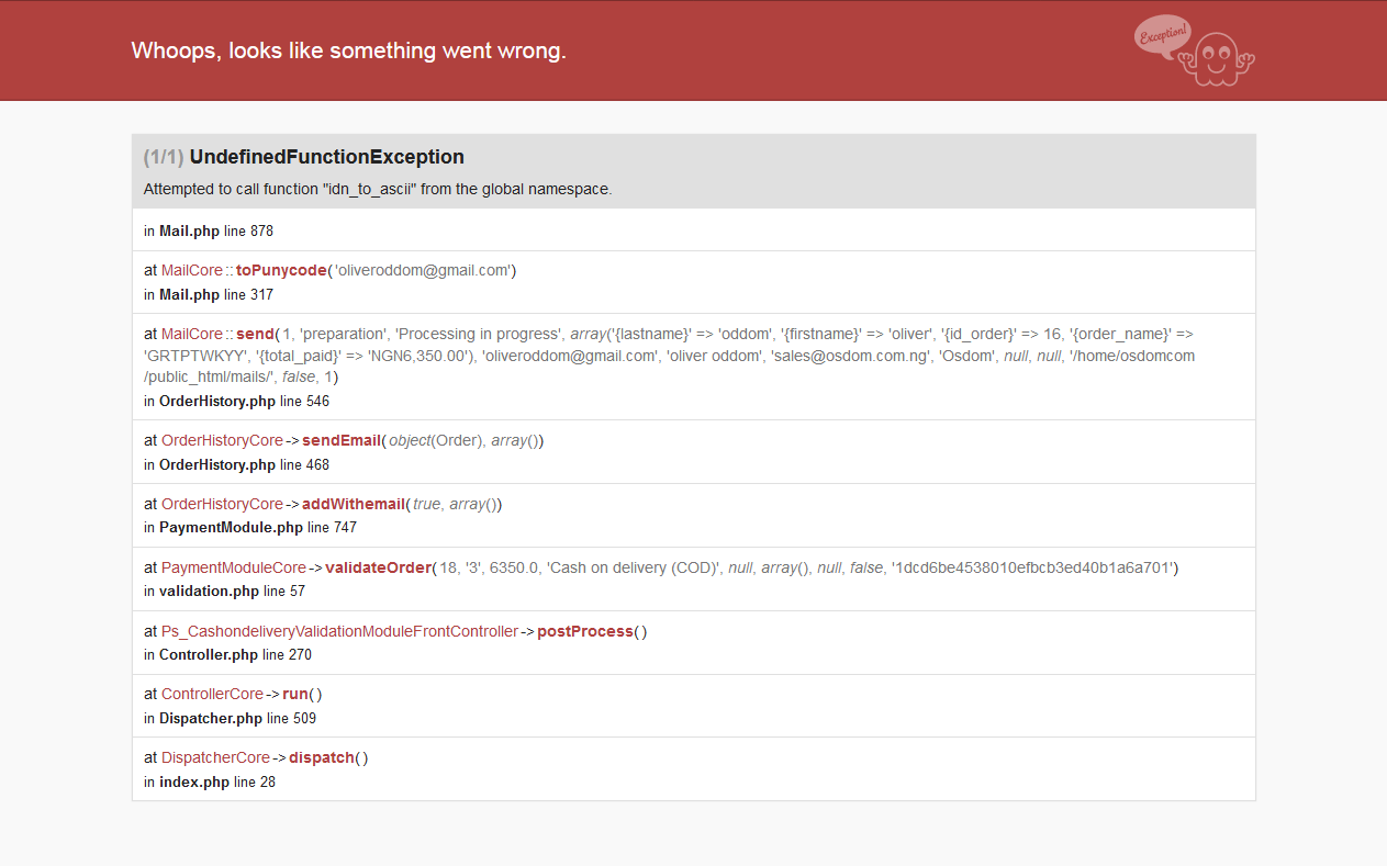

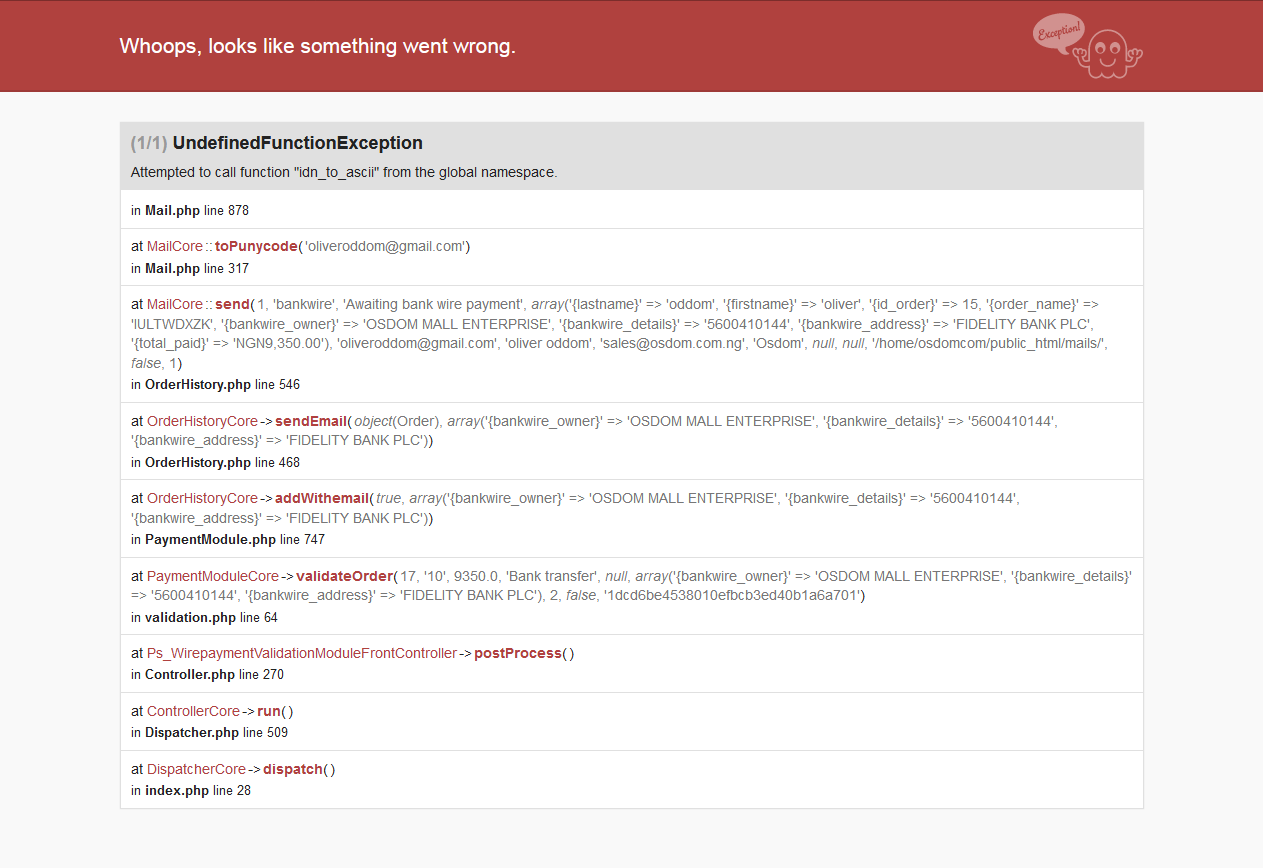

osinachi Posted January 12, 2019 Share Posted January 12, 2019 please i need help with this issue after placing an order instead of the next page to be order confirmation/validation it shows blank/white page page, am using version 1.7.5, this happens with all the payment methods am using cash on delivery, bank wire and paystack. i enabled the debug mode and got this below error. please i will appreciate any help. thank you Link to comment Share on other sites More sharing options...

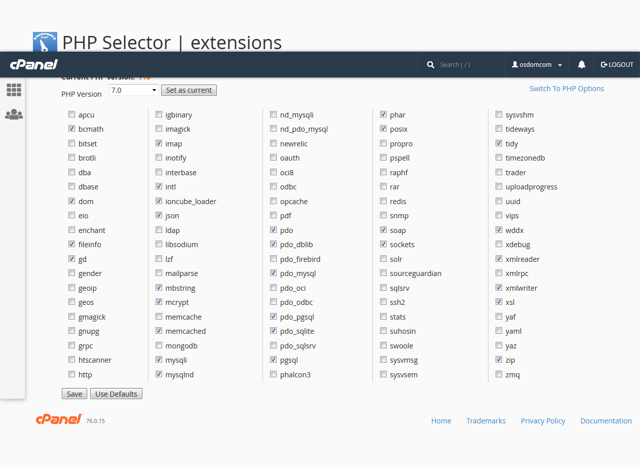

osinachi Posted January 13, 2019 Author Share Posted January 13, 2019 yes i contacted my hosting partner and they could not give me a good response, no i dont have access to a webmaster or a prestashop developer, ok am using php version 7, i also noticed the intl extension was not enabled , i did enable it and yet the same problem persists 1 Link to comment Share on other sites More sharing options...
