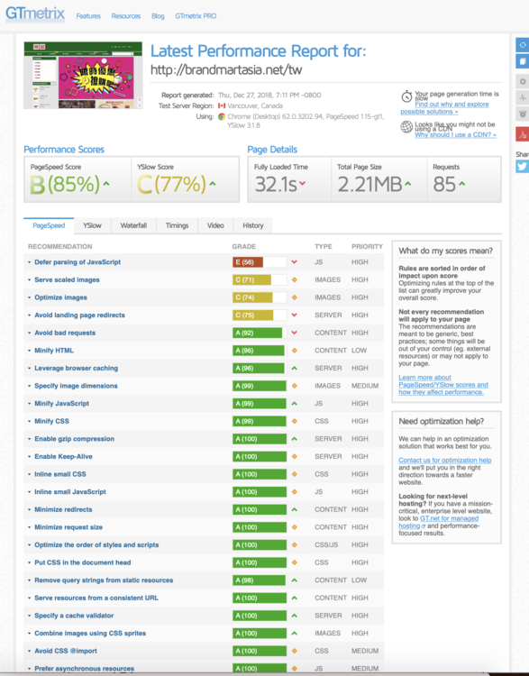

jaden Posted December 28, 2018 Share Posted December 28, 2018 Hi, My Shop is running really slow after I transfer to new hosting. I have enable Profiling and result with below number, does those number can tell what caused my shop so slow? I have enable those Caching mode refer Prestashop advise to speed up the site, but still slow. Attached GTMetrix result I am new prestashop, need some expertise to advise, can anyone advise and help. Thanks Jaden Load Time 1609 ms - You'd better run your shop on a toaster Querying Time 533 ms Queries 641 Memory Peak Usage 47.6 Mb Included Files 530 files - 9.02 Mb PrestaShop Cache - Mb Global vars 0.13 Mb PrestaShop Version 1.7.4.3 PHP Version 7.1.22 (OK) MySQL Version 10.2.12-MariaDB-log (OK) Memory Limit 1024M Max Execution Time 1000s Smarty Cache enabled Smarty Compilation auto Time Cumulated Time Memory Usage Memory Peak Usage config 266ms 266 ms 10.95 Mb 11.25 Mb __construct 27ms 293 ms 1.60 Mb 13.17 Mb init 180ms 473 ms 6.04 Mb 19.19 Mb checkAccess 0 ms 473 ms - Mb 19.19 Mb setMedia 0 ms 474 ms 0.01 Mb 19.19 Mb postProcess 0 ms 474 ms - Mb 19.19 Mb initHeader 0 ms 474 ms - Mb 19.19 Mb initContent 968ms 1441 ms 22.35 Mb 41.06 Mb initFooter 0 ms 1441 ms - Mb 41.06 Mb display 167ms 1609 ms 5.78 Mb 47.64 Mb Link to comment Share on other sites More sharing options...

PrestaHeroes.com Posted December 28, 2018 Share Posted December 28, 2018 gtmetrix provides 'several to do's'. I'd rely less on ps profiling and more on gtmetrix and lighthouse. since you experienced this problem aftere moving to new hosting, then suspect new hosting. there are a lot of things one can do within hosting primarily in tuning your mysql settings, see phpyamdin, click loalhost and status...phpmyadmin even tells us in red what is not configured correctly. but if shop slowed down after move to new hosting, then it's hosting so looking at it from PS is not time well spent. Link to comment Share on other sites More sharing options...
