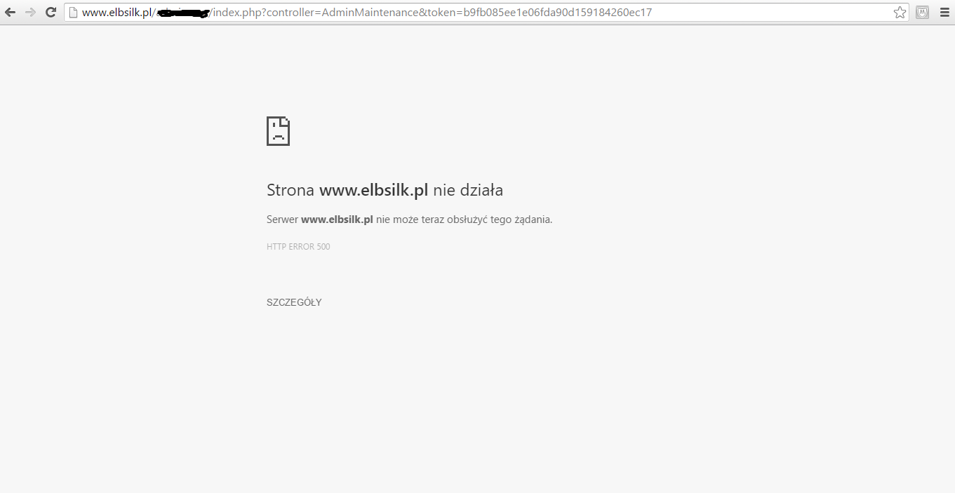

Voyteack Posted August 30, 2016 Share Posted August 30, 2016 Hello, I have a problem with HTTP 500 Error. I tried to look for the solution here and there and nowhere was the one that could help me. The problem is that I can not Save any changes, it started with Maintenance mode, which I could not turn on. After saving HTTP 500 Error popped up (img PH1.png) . The same thing happened when trying to save logo of the shop. I asked hosting to explain what happenned as usually http error 500 refers to hosting, however the answer from them was that handler php does not freeze, the http 500 error is sent to the browser by the software itself (prestashop in this case, to be exact version 1.6.2) Can anyone help me with it? Link to comment Share on other sites More sharing options...
PrestaHeroes.com Posted August 31, 2016 Share Posted August 31, 2016 Hi, 500 is generic, please enable PrestaShop debug mode to see underlying php error. https://www.prestashop.com/forums/topic/224525-how-to-turn-on-error-reporting-for-debug-information-blank-page-500-internal-server-error/ Link to comment Share on other sites More sharing options...
