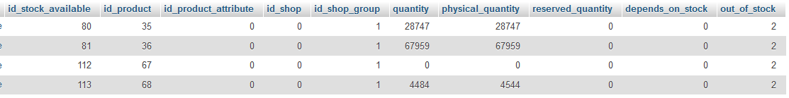

01generator Posted January 20, 2017 Share Posted January 20, 2017 Well I came up with another solution. You are making all the changes in the database. 3 to 4 queries are needed. First of you change the value in ps_shop_group from 0 to 1 in share_stock column. Then you run the following simple queries. UPDATE ps_stock_available SET id_shop_group = 1; #assuming your id_shop_group is 1 DELETE ps_stock_available WHERE id_shop = 2; #my default shop is id 1 and i want the quantities from shop 1 UPDATE ps_stock_available SET id_shop = 0; #thats the final trick! I have not tested this very far but so far I did not face any issues. Back Up you database always Eneble maintenace mode before changes Re back up database just to be sure HINT: After you issue the last query go to your dumb sql file and retrieve all the insert queries for ps_stock_available and run them in your DB. If you do that you will be able to return to these values if you disable share stock option in multistore. Furtheremore I strongly believe that these values are needed. 1 1 Link to comment Share on other sites More sharing options...

hardstonepaul Posted November 4, 2018 Share Posted November 4, 2018 (edited) Hello i have Prestashop 1.7.4.3 I started with Two Shop groups but no working after thinking i decide work only whit One Group, i make some changes on the DB: Delete the group_shop (In this case) 2 Put all shops on the default group, on group 1 Go to stock_available and set the column id_chop all in 0 (teke care that you no have repeat product with different id_shop) Really i don't know why (if some one can explain) but work for me. Regards Edited November 4, 2018 by hardstonepaul (see edit history) Link to comment Share on other sites More sharing options...
