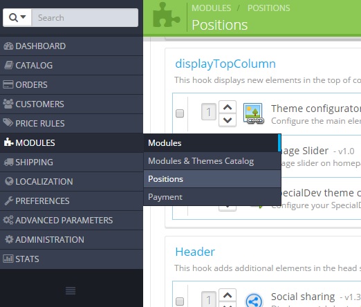

DawnyT Posted June 21, 2015 Share Posted June 21, 2015 Hi guys, Hoping someone can help me with this as I'm really struggling here, When in my admin panel modules > Modules i get the following error message Internal Server ErrorThe server encountered an internal error or misconfiguration and was unable to complete your request. Please contact the server administrator, and inform them of the time the error occurred, and anything you might have done that may have caused the error. More information about this error may be available in the server error log. Is this a problem within prestashop or on my server and how do i correct this? Im running Prestashop_1.6.0.14 with a custom template purchased from presta store. Many Thanks Dawn 1 Link to comment Share on other sites More sharing options...

DawnyT Posted June 21, 2015 Author Share Posted June 21, 2015 I dont know how to switch on debug mode im a total beginner. I've been looking for some type of error log on my ipage control panel but cant seem to find one. I recently purchased a theme from prestashop addons that added a lot of extra modules. There was an error before i installed the template but it was intermittent and only happened on and off. Now i have the permanent 500 error. Link to comment Share on other sites More sharing options...
