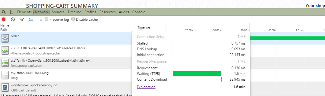

Guest Posted April 15, 2015 Share Posted April 15, 2015 The image suggests it is a time to first byte issue, but does not explain why But at least it gives you another way to search. "TTFB prestashop" suggests memcahce can be an issue (if that is on, switch it off) https://www.prestashop.com/forums/topic/253785-solved-impossibly-slow-loading-pages-time-to-first-byte-7-seconds/ Not sure where else to go now except if you have re-instlaled prestashop it is really unlikely to be an issue with the software otherwise everyone would have the problem and much more likely to be an issue with your hosting server Can you run a phpinfo test and see what your settings really are in php? Link to comment Share on other sites More sharing options...
