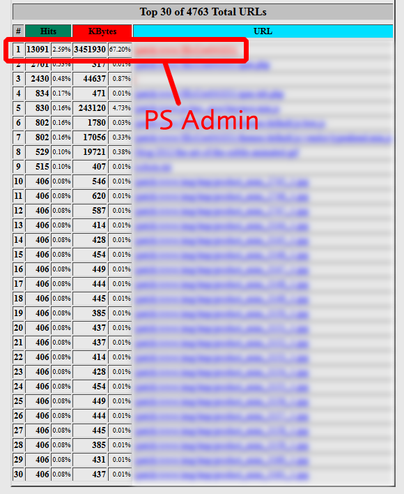

designdpi Posted March 13, 2015 Share Posted March 13, 2015 Hi all, whenever I work on a new PS site I always host it on my development server until ready to go live. This applies to my current project running PS 1.6.0.8 where I am facing a really curious problem, one which I've never encountered (or at least been aware of) with previous versions. The issue is bandwidth. Last month I went to my website to find 509 bandwidth limit exceeded. I was surprised to say the least, so I did a bit of digging in my Control Panel and I found that PS Admin was causing an obscene amount of traffic both in requests and bandwidth... screen grab attached: It was primarily the admin folder (67% of ALL traffic), but also quite a few hits from js/tiny_mce/tinymce.min.js admin/ajax.php and admin/ajax-tab.php (accounting for around 5%). So my question, what the heck is going on, and how can I get PS admin to go easy on my server? We're not even half way into the month and I'm already worried I'll be running out of bandwidth very soon Has anyone else encountered this? Link to comment Share on other sites More sharing options...

designdpi Posted March 13, 2015 Author Share Posted March 13, 2015 Many thanks for the suggestion El Patron, although that looks a very useful module which I will most certainly look into further, I don't think it is the solution to the question posed.Namely, why if logged in to the back office for a couple of hours, are there 1,000's of hits generated by the back office and a ridiculous amounts of bandwidth used. Link to comment Share on other sites More sharing options...
