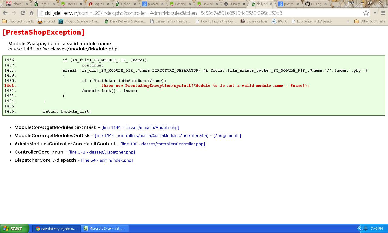

kgnaraandiran Posted February 25, 2015 Share Posted February 25, 2015 After Upgrading to 1.6.0.13 from 1.6 I am not able to access installed modules please help me Also I am Afraid that some more unknown problems too exist screen shot attached Link to comment Share on other sites More sharing options...

PrestaHeroes.com Posted February 25, 2015 Share Posted February 25, 2015 After Upgrading to 1.6.0.13 from 1.6 I am not able to access installed modules please help me Also I am Afraid that some more unknown problems too exist screen shot attached 1.6.0.13 now checks that module directory name is 'lowercase'. check and reaname modules/Zaakpay is modules/zaakpay, if not change to lowercase. 1 Link to comment Share on other sites More sharing options...

PrestaHeroes.com Posted February 25, 2015 Share Posted February 25, 2015 I recreated this issue with uplaoding Zaakpay to a 16013. Note this uses DreamWeaver editor... http://screencast.com/t/cnpCi2iCqJ2E This resulted in 'same' error as original poster: http://screencast.com/t/7TkmccgR1h After renaming folder modules/Zaakpay to moodules/zaakpay...I did not get error. so most likely whatever 'view' you are using, does not display uppercase...rename using lowercase... Link to comment Share on other sites More sharing options...

kgnaraandiran Posted February 26, 2015 Author Share Posted February 26, 2015 Thanks Mr. El Patron for your valuable help, changing to lowercase solved problem Link to comment Share on other sites More sharing options...
