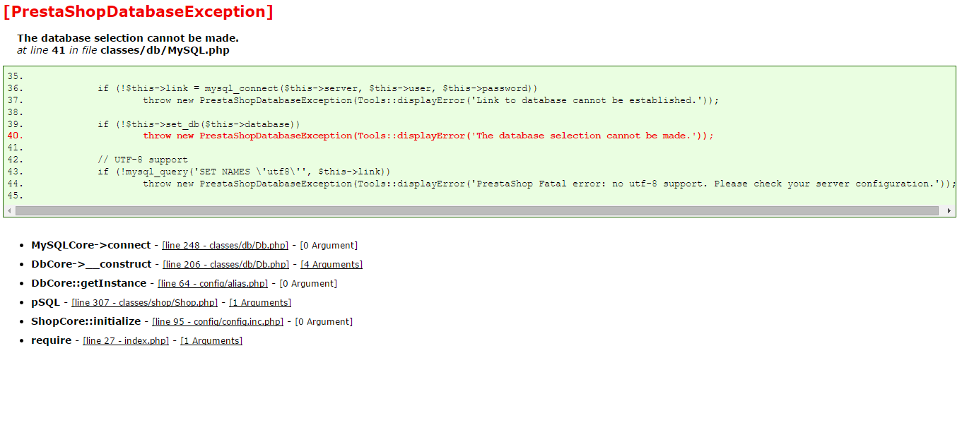

werttech Posted February 13, 2015 Share Posted February 13, 2015 Hello Team we are facing some different problem our website works perfectly on shared hosting but it gives issue on our vps, after doing this define('_PS_MODE_DEV_', true); we found these errors just don't know what to do?? plz help thnx in advance Link to comment Share on other sites More sharing options...

helldog2004 Posted February 14, 2015 Share Posted February 14, 2015 Open you shop in FTP and go to /config/config.inc.php In here change all your DB information as this is changed while changing server. The error you are receiving is that the website can not find any products on the server you specified. That is because your DataBase has also been moved. Link to comment Share on other sites More sharing options...

werttech Posted February 17, 2015 Author Share Posted February 17, 2015 getting this error after above Link to database cannot be established: SQLSTATE[HY000] [1044] Access denied for user 'oceanhan_shop'@'localhost' to database 'oceanhan_shop Link to comment Share on other sites More sharing options...
