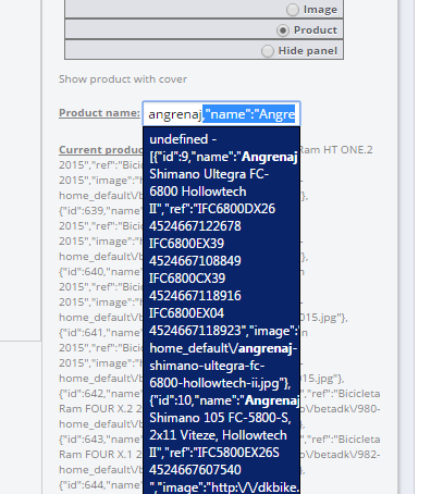

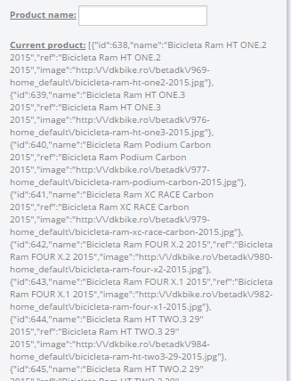

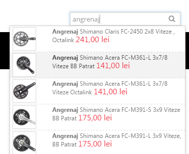

kornfr333k Posted January 23, 2015 Share Posted January 23, 2015 Hi, i have a weird problem, since the last update of prestashop, that i just noticed. In my mega menu module i have the option of placing one product to be showed in the right side of the pane. I add the product by typing in a product name in the selection box, and it usually lists products in a drop-downn list, for me to select. (just like in the search box.) But now i get a weird string, containing all my product names, and i cannot select anything. The string starts with " undefined - [{"id":638,"name":"Bicicleta..... " and it goes on just like this, listing all my products in one string. i have attached two screens of my problem, hoping you can help me solve this. it should look like this: I need to mention that today i had a weird problem when all the names of the modules dissappeared from the modules list, and i had to make some modifications to classes/Translate.php with THIS fix from GitHub, and that problem was fixed. i don't know if it's related, but i really need some help. I want to mention that this only happens in the configuration page of that mega menu module. thanks Link to comment Share on other sites More sharing options...
