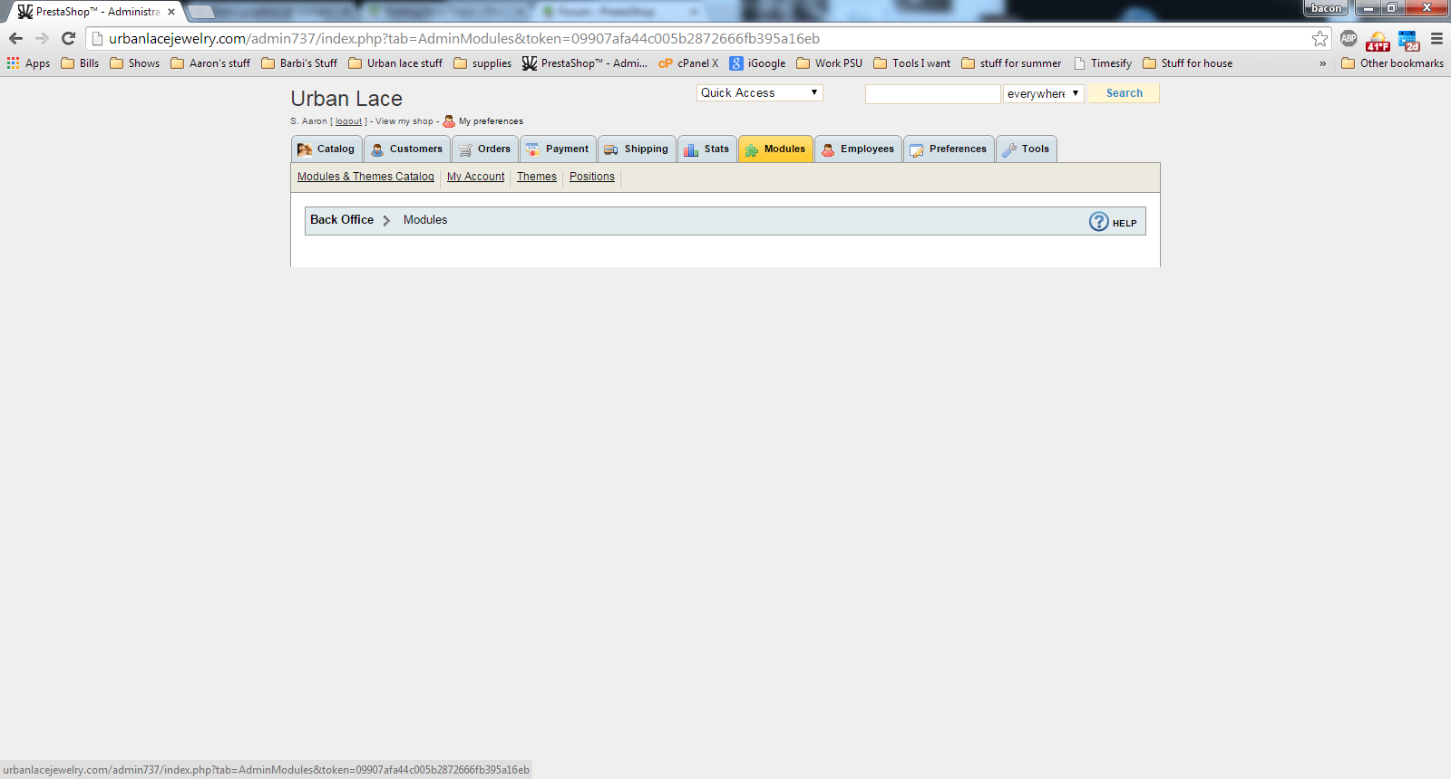

urbanlace Posted January 22, 2015 Share Posted January 22, 2015 The Modules tab in my Prestshop Adimistration Panel does not have a list of the modules I have installed/available. It was there and then it was just gone one day. Poof! Does anyone know why this would happen and, more importantly, how do I get them back? I should add that the modules are all still there, when I click on the positions subtab they all appear. The problem is, I can not configure/install/delete modules from the positions subtab. Thank you in advance for the help, Aaron Link to comment Share on other sites More sharing options...
PrestaHeroes.com Posted January 22, 2015 Share Posted January 22, 2015 this is typically a result of an error loading modules, i.e. a module is taking a fatal error. you can enable ps debug mode to cause error to display when you visit module page https://www.prestashop.com/forums/topic/224525-how-to-turn-on-error-reporting-for-debug-information/ make sure to turn off when done Link to comment Share on other sites More sharing options...
urbanlace Posted January 22, 2015 Author Share Posted January 22, 2015 Thank you. That let's me know where the error is reporting from. Now I just need to the error fixed. /home4/urbanla2/public_html/modules/backwardcompatibility/backwardcompatibility.php on line 163 This error might be beyond my limited coding abilities... Link to comment Share on other sites More sharing options...
PrestaHeroes.com Posted January 22, 2015 Share Posted January 22, 2015 see if this post helps https://www.prestashop.com/forums/topic/245502-backward-compatibility-issue/?p=1392664 I am only guessing you are on 1.4, helpful to post your ps version. Link to comment Share on other sites More sharing options...
urbanlace Posted January 23, 2015 Author Share Posted January 23, 2015 Thanks for your help! I deleted the backward-compatibility module completely and installed a new version of the PayPal module. Problem solved! Thanks again! 1 Link to comment Share on other sites More sharing options...
