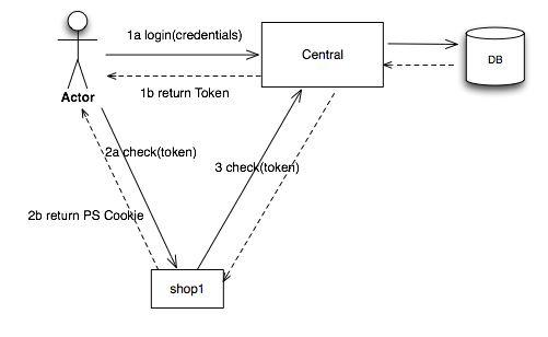

hpar Posted September 22, 2014 Share Posted September 22, 2014 The user has to call each shop directly (to get the shop's cookie). But during this call, the php code on your shop have to authenticate the user with your main server, you can use something like a token. Link to comment Share on other sites More sharing options...

Wazzu Posted September 22, 2014 Author Share Posted September 22, 2014 Thanks, hpar If you send the login/password to each of the autologin.php then there is no need of a central auth (with token / nonce as I suggested previously). Sorry, I think I don't get you My "central" application creates an empolyee using PS API and stores email/passwd in database. Then I use those parameters to remotelly generate a cookie in the shop side just before redirecting the user. Isn't it too complicated creating a token for this situation? Anyway I would have to "authenticate" the token instead of the user/pass, isn't it? So how would you use the token? Don't forget to add CORS headers. I know, I know, this is just a proof of concept Link to comment Share on other sites More sharing options...
hpar Posted September 22, 2014 Share Posted September 22, 2014 Isn't it too complicated creating a token for this situation? Anyway I would have to "authenticate" the token instead of the user/pass, isn't it? So how would you use the token? Yes it's way more complex and probably overkill for your project. 1 Link to comment Share on other sites More sharing options...
Wazzu Posted September 22, 2014 Author Share Posted September 22, 2014 Ok, that's the same image I had in mind. In this moment, I will make it as simple as... my client will pay me xDD. Thanks for sharing with me your point of view Link to comment Share on other sites More sharing options...
