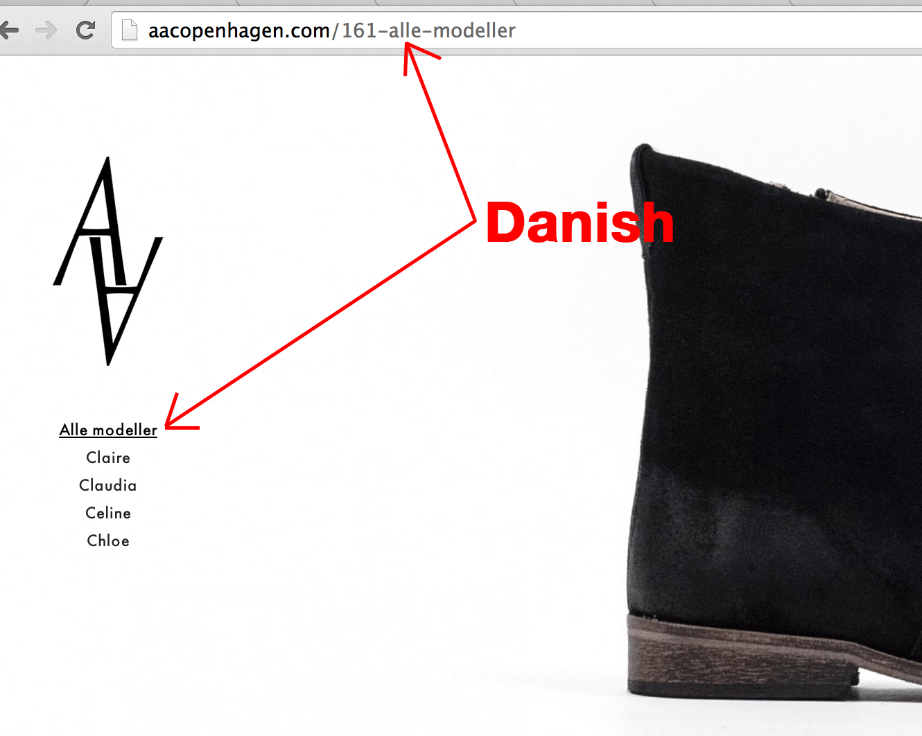

alpe09ag Posted September 3, 2014 Author Share Posted September 3, 2014 (edited) That is strange! I deleted the content of the following folders: cache/smarty/compile cache/smarty/cache img/ tmp Then I cleared all cache and cookies "forever" in Chrome. Then opened Chrome in Incognito mode and Force refreshed the site. But the site is in Danish Edited September 3, 2014 by alpe09ag (see edit history) Link to comment Share on other sites More sharing options...
alpe09ag Posted September 3, 2014 Author Share Posted September 3, 2014 (edited) Any idea why you see the english version and I see the Danish version? What happens when you go to this link: http://aacopenhagen.com/161-all-models When I click on that link I am being redirected to the danish version: http://aacopenhagen.com/161-alle-modeller Edited September 3, 2014 by alpe09ag (see edit history) Link to comment Share on other sites More sharing options...
